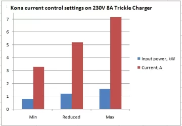

Here in N.A. we have a separate charge current reduction setting for L1 (120V) and L2 (240V), a picture of that screen in the charge management might help, possibly there is only the one setting in your area assuming Australia, in which case a full reduction may be the only option using your existing EVSE.
That should work at the “minimum setting”. Yes, we have just one AC rate adjustment in our 230V-only countries.
Other options might be if the wall box has an internal adjustment for 16A, or use the 8A portable unit.
What wall box do you have? My Wallbox wall box has an app that enables me to adjust the amperage. I can theoretically charge from as low as 6 amps to 32 amps. I often finish the last 10% with 10 amps which is about 2 kw from memory. I have never tried to adjust it through the car's BMS.
Oops, I'm wrong about the portable and station settings, we have both in our 230V-only countries. I believe the delineation falls between 13 and 15 amps.
I measured this result some years ago for the 8 amp portable but I think the ratios are the same for whatever current the EVSE offers the EV.

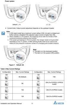

Shut off breaker, take cover off, set dip switch (as shown up, down, down) to 100 for a 16A draw (first 3 positions from left). This should get you 3680 W, exactly what you want. The car will tell you the kW charging to verify. No electrician required.;)
Hi Eddy, just thought I'd let you know, i set the far left set of switches to down, up,up. As per the picture for 16A above. It now charges at around 3.1 KW which is just about what I need. I'm curious though, the switches were all up when i opened it. Picture above suggests thats 6A? How would that allow 7kw charging if its set to 6A? Maybe my understanding of ampage is a bit screwy :).
Either way, happy now.
