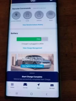

To make it worse, when I got home and plugged the 120 volt charger in, the app said "Charger is plugged in 240 volts." And it would not charge at all.
I finally unplugged the charger and started it over. This time it started charging, and the app said, "15h 40m left to full charge."
That was an inconvenience to me, but what if I had previously accidentally set the DC charge to 10 % when I meant to set it to 100%. That would have been a pretty big problem if I were on the road and could not set the level to some value greater than 10%. Is it true that you cannot override the setting in the MyHyundai app? And have others experienced these strange problems?
