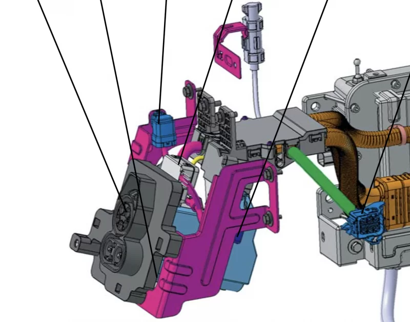

2019 limited, 31,000miles."Charging door open" message stays on even though the door latches securely and both plug caps are in place. I have cleaned out all dust from charging port area, the door and the door hinge. I could ignore the message but the 12 warning beeps that come on each time the car is started, the brakes applied, the wipers activated, etc. are annoying, especially in city driving. Any suggestion as to how to disable the warning beeps (and message) or how to diagnose and fix the problem would be greatly appreciated. The only Kona EV dealer in my state can't get to it until mid-October.
I have no access to the wiring diagram and did look under the hood for the connector with the leads from the door closed sensor, but could not locate.
The wires are the 2 on the bottom right coming from the latch itself:
index.php
which is located within the door assembly itself (non-accessible without front nose removal):
index.php
It does indeed sound like that contact is not working. If it were my car and had to listen to all those warnings, I would start troubleshooting by checking continuity of the motor compartment (2) fuses labelled "Charger2" (ICM relay box, (Charge Lock/Unlock Relay), CCM Unit) 10A, and Charger 1 fuse (Charge Connector Door Module) 10A, as listed in the owner's manual. If the fuses are good, possibly by leaving one of them out (probably the Charger 1 fuse) the warning beeps may be eliminated. Of course, the fuse would have to be re-inserted when charging.
Thanks to @KiwiME for the above photos.
