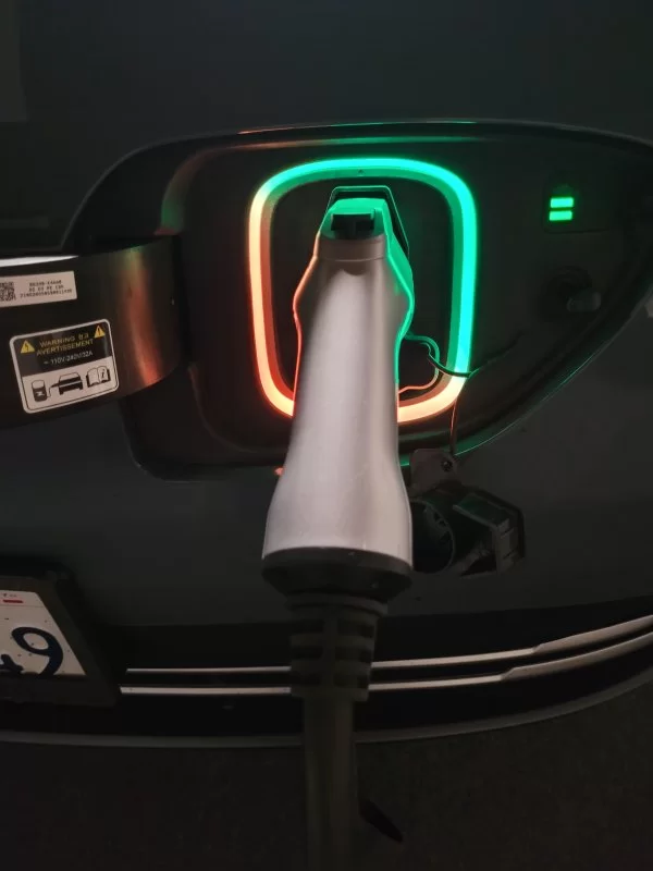

E EBRP New Member Mar 14, 2022 #1 Has anyone else seen their charging port lit half green and half orange while charging? What does it mean?
electriceddy Moderator Staff member Mar 14, 2022 #2 EBRP said: Has anyone else seen their charging port lit half green and half orange while charging? What does it mean?View attachment 15634 Click to expand... Need charge port replaced - water has gotten into the ring light LED module: https://www.speakev.com/threads/charging-port-showing-both-green-and-red-colour.147193/#post-2785015 BTW it is just cosmetic- should still charge fine
