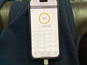

I might have the same issue. I have the problem once in my early days of owning the car, and did not have any issue even after the recall. 90+% I charged with the OEM L1 charger at home. But on the weekend before Xmas, I took a long (900KM+) 3 days round trip out of town and encountered many repeated issues. According to the Mini app, I did 31 charging sessions using L2 and L3 charging stations. But after studying the report, there are 16 failed attempts all related to L3 chargers. I remember that in most cases, the charger was connected and my credit/membership card was accepted and car connected without issue and once charging started, the charger immediately stopped charging. The error message was "charging interrupted" or "charging completed". Then I was instructed to unplug in order to start another charge.
At first I thought it could be the chargers did not like the Mini, or the Mini did not like the chargers. I called one customer service and she even restart the charger remotely but to no avail. One driver told me that once in a while he had to plug and unplug several times before charging would start. At one charging station, I had to do that 9 times with no success. Luckily one driver told me to go try a L2 charger that was some distance away. It worked, but I have to spent more than 2 hours before I can get enough juice to go to my next stop. After the L2 charger, the Mini was able to charge with a L3 charger for a couple of times. Then it happened again, and at one L3 charger I had no choice but had to plug and unplug. Luckily after 3 tries I was able to charge with the L3 charger and again for a couple of times before the end of my trip.
