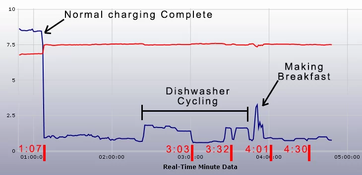

I've been getting notification e-mails that my charging is complete periodically this morning and decided to investigate. I have a TED2000 home energy monitor installed in the main panel which records the power and voltage of the entire house, plus the Chargepoint EVSE has its own data logging so I can see what the car itself is doing separately.
Here's the TED2000 data, which I annotated the blue line (Power, in KW - red line is system voltage). Red marks along the bottom are times I received "Charging Complete" e-mail notifications, time based on the e-mail timestamps.

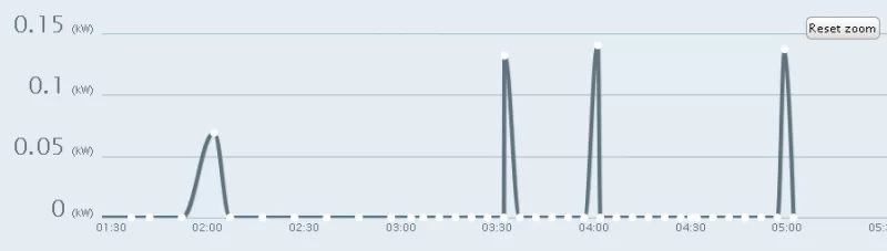

Now here's the data from the Chargepoint EVSE, zoomed in a bit so the 1AM charge complete event is just off the left edge:
So while the Chargepoint logging doesn't seem to have the time resolution needed to catch every instance, the car is clearly pulling power for short bursts every half hour or so.
The TED2000 logs two hours worth of second-resolution data. Examining this, I found one matching spike at around 4:30 which was 150W for 2 seconds, then 350W for another 2 seconds. There was also another spike at 2400W for 3 seconds (!?) at 4:59:17 which corresponds with the Chargepoint spike at that same time, though Chargepoint only registers 140 watts at that spike. No idea what that's about but it's hard to believe that timing is pure coincidence! It's also been half an hour since and I haven't gotten another "charging complete" notification.
