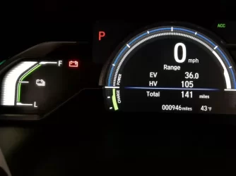

Many of us have found the 'fuel gauge' or in the case of the PHEV, 'electric gauge' to be very inaccurate. The other day, with a stated range of 35 miles after a full charge, I drove 8 miles and the graphical gauge on the left side of the instrument panel still showed full. Don't believe that graphical gauge on the left, it's just horribly inaccurate. I use the user selectable, mileage indicator. On the PHEV, you get a numerical readout of gas mileage remaining and electric miles remaining. If I could turn off the electric graph on the left, I would.
The "fuel" gauge is inaccurate, but if it shows full and the car won't charge anymore, the car is charged to full. The confusion is the range indicator information screen you mention is it shows a graph that looks like a fuel gauge, but when fully charged if your range is less than EPA rated it looks like the car is only charged partway. I had this same issue so I kept trying to charge the car more and it wouldn't charge, and to make matters worse Honda just has a green light meaning charging and no light meaning it is fully charged or not charging. This leaves the driver with the question, is it fully charged or is there an issue with charging?

Just so we're all on the same page, here's a picture of the gauges in question. In the center is the numerical readout of the electric range, shown as 'EV'. In this case it's 36 and the battery is fully charged. On the left is the graphical depiction of battery charge that I find almost useless. It will show this same full state even after I've shaved off 6 or 7 miles of my actual electric range.

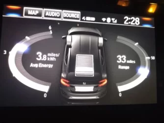

The confusing one is go to View Information on the center screen and select the option Vehicle Energy it think it is called, the one that shows where the power is coming from or going to.
The center console has a gauge that shows range and the car can be full, but if range is less than EPA range it looks like it is only partway full, even if the "fuel" style gauge on the left looks like your picture.

I am pretty sure he is talking about the "Energy Flow Screen" on the center console (under info sub menu on my PHEV). See page 203 of BEV owners manual.
I was confused by this in my PHEV as the car is fully charged, but the driving range on the "Energy Flow Screen" shows the range as a gauge and if you are less than EPA rated range, it looks only partially full. For example, if your fully charged range is showing as 60 miles and car is full, this gauge will only show 2/3rds of the way up. Bad design move by Honda, they should just show the range number.
Exactly that screen, if your car is fully charged and your guessometer is showing like 60 miles due to cold weather or some other factor, it makes it look like your battery isn't fully charged. The PHEV has the range on the left if I recall as it doesnt have the avg efficiency.
The point is, range isnt a fixed number, it shouldnt be in a gauge style display with a full and an empty. Same with efficiency, does that imply the car can never get better than 6 mi/kwh? They are arbitrary points.

I dont care when it was taken, the point is if when fully charged and showing 60 mile range that gauge makes it look like the battery isnt charged. That gauge shows only how well you are doing against EPA.
My guess is you are in a warm climate and dont see large range drops that acompany heater use or maybe mountain driving.
I will snap a picture of my PHEV, and with the single digit highs we have had all week, the car when fully charged shows half full on that display.
