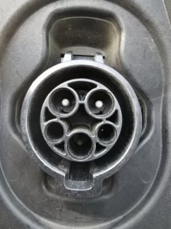

My OEM charger is no longer able to click into the port to begin charging on my 2020 Clarity. I was able to charge at work using a Chargepoint station just a few hours ago, but when I got home I noticed that my own plug was not working. It's seems the plug is not seating in properly and the button on the handle isn't able to click in. The plug is very loose and able to wiggle around, which is something I hadn't experienced before. Anyone else have this issue and any solutions?

If you don't see anything blocking the seating of your charging handle, is there a nearby public EVSE you could try? Can you post a photo of your charging port?
Hi,
Just checked with two public EVSE around me. One did not work at all. The other was a charge point station that initially did not work until I put a bit of force into pushing the plug into the port. Even so, the plug was at an odd angle and did not make the nice clicking noise it usually makes when connecting. It seems that all the plugs I tried were very loose and unable to make a tight connection. I'll upload a photo of my port.

Your experience at the other EVSEs certainly points to your charging port having a problem, but I don't see any obvious problem in your photo.

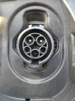

So I blew some compressed air into each section of the the port and a small circular gray piece of what appears to be part of the Chargepoint plug from my workplace flew out from the bottom port. It was lodged in there preventing the charger from being able to completely snap in. It can be seen in this photo. I found a similar post from someone on another Clarity forum that had the exact same issue and fix! Thanks for your help

I don't see the Chargepoint material in your photo, but I'm glad the fix was so easy.
