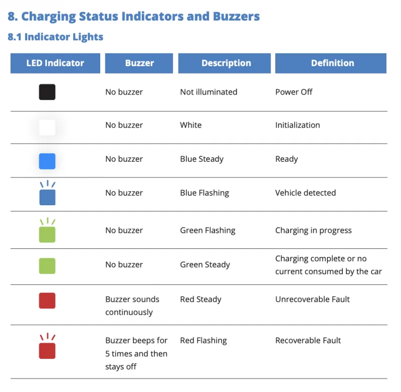

Both times, the light on the Grizzl-e indicated it was waiting for the car to respond when I plugged it in, but no light in the opening on the car. Both times, I got it charging by unplugging, starting the car for a brief time, and then plugging back in. But it took several tries to make it go.

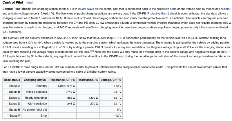

The protocol is very simple - the charger provides a +/-12V square wave on the CP pin whose duty cycle represents the amps available, 6 to about 80. The EV sees that and loads one half of that signal with a resistor to indicate that it's ready to charge and on seeing that the charger then closes its relays to provide the current. The charger normally doesn't care what current actually flows but the Grizzl-e may have additional proprietary functionality past that.
No light of any sort around the charge port when plugged in (until I got it working, and then the usual green around the port and the small flashing orange). Except one time it was white around the port (and I can't remember if the orange showed or not), but it wasn't charging. The Grizzl-e has been very reliable and I'm very used to getting the green light around the port and the green or orange little light flashing.
Sorry, I see you did mention the car light earlier. Either the charger is not outputting the control signal or the Kona is not responding to it.

Regular charger worked this morning, so I'll have to wait for the next time it fails to try the portable charger. Although I did note that the manual for the Grizzl-e said the flashing light I got said the charger was waiting for the car to respond when it wouldn't start. I'm also going to go out and clean the contacts with contact cleaner in case (hopefully) it's just a bit of crud in there causing this.
