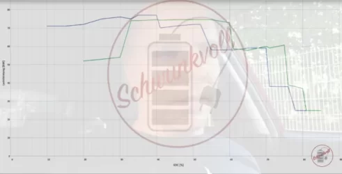

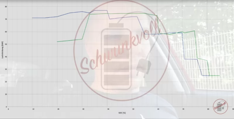

On our road trip from Florida to New York, before the SERVICE CAMPAIGN 960 update, using the Electrify America charging network, we found that the charge rate drop off curve (blue line on the graph) to be fairly accurate.
Hyundai updated the software on our Kona, but we have not tried a DC fast charge yet.
I did find someone in Germany that had the update that shows the new charge rate drop off curve (green line on the graph).
According to my calculations, and using my previous road trip as a guideline, the time to charge from 10% to 80% was about 50 minutes.
My calculations after the update comes out to about 45 minutes for the same charge using the new charge rate drop off curve.
I don't know what the curve is for a 50kw charger, we only used the 125kw and up.

I suspect the curve in the attachment represents something higher than a 50kw charger as the charge profile peaks well past that. My recent experience on a 250 kw rated petrocanada charger(likely only 150 max potential delivery) I observed the following after the software update: The charge session went from 5% to 61% SOC . The BMS battery temperature at the start of the session was 25 degrees C. The charger immediately started at 68 kW slowly ramped up to a max charge delivery of 75 kW at 32% SOC and the ramped down to 70-72 kW at 40% SOC and ramped down again to 58 KW at 59% SOC. The session ended with 40.6 kWh delivered over 34 minutes for and average of 71.6 kW delivery over the entire session. This is consistent with your German poster's charge profile except with the very beginning where I suspect their battery temperature was under the optimal 25 degrees C. Take home from the new changes seems to be that the max delivery has been reduced from 78 kw to 75 kw( not sure if this is a consequence of the electrify america thing). The delivery at the highest 70Kw rate seems to last a little longer and overall charge session was shorter/cheaper( if charged by time delivery).
