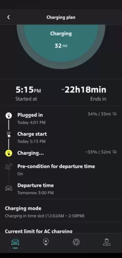

I just got my car this week and have now failed twice to have it charge in the middle of the night (when rates are lowest).
The first night it simply didn't charge at all overnight. I set the Charge in Time Slot to midnight to 3p. I can't remember my other settings.
Today at 4p, I reset the Charge in Time Slot to midnight to 3p. I also chose a 3p tomorrow/Friday departure time (not sure why I should need to set a departure time to set a time slot - sometimes I need to charge but don't know when I will next leave home). At 515p, however, the car started charging (almost 7 hours before I wanted it to start).
Anyone know what I (or the car) am doing wrong? I checked the clock on the car and it had the correct time. I also wondered whether the car started charging early to ensure it got to 100% by my 3p tomorrow departure time. I don't think this is it, however, as I still got a warning that the car wouldn't fully charge by my departure time.
Thanks in advance!
Looking at the following text from the manual, I think that the car indeed started charging before the low cost time slot because it was trying to finish charging prior to the departure time.

If the didn't start charging until midnight (the start of the low cost time slot), it wouldn't have gotten close to 100% by departure time (3p). Given slow Level I charging rates, I am not sure it is possible to confine charging to the low cost time slot, especially if the battery is close to 0% and it would require >20 hours to charge to 100%. Thus, it is prioritizing getting to a full charge, even if it means charging during higher cost times outside of the Charge in Time Slot. This probably wouldn't be an issue with a Level 2 charger as you should be able to get to 100% within 8 hours or so, ideally fully within the low cost time slot.
Yes, the departure time is the culprit. The wall charger takes a very long time, so it is over-riding your charge parameters to assure your car gets charged. Try going to a fast charger to get it to 80% first, and then see if it charges in your desired slot when you are home. I wonder if you can use a smart outlet with it? You may eventually want to install a level 2 charger if you can, it makes life easier.

We have discovered that if your departure time is within or up to 30 minutes after your cheap rate window, the MINI will begin charging at some time it selects within the window to finish on time (or sometimes a couple of minutes late).
But, if you set your departure time at least 31 minutes after your cheap rate window, the MINI will begin charging at the opening of the window.
However, the MINI prioritizes a full charge and will begin charging as early as it thinks it needs to, to reach 100% by departure time, including before the window, if necessary. For this reason, and because of the increased efficiency of charging at high Wattage, if you have a significant nighttime power discount, it would be worth it to have L2 installed in your home.
