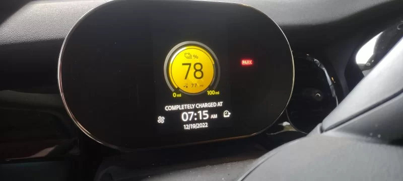

It's 4:45pm Saturday. I am giving my SE an unscheduled charge as I'm going out tonight, it's sucking 7.2kW, as usual.
Display is telling me I'll be fully charged on Monday at 7:15am. Yes, that's when my next climate control session ends...
I am sure every other time I've just plugged it up, it has shown a very good estimate of when my charge will hit 100%
When I fast charge, I'm sure that it shows a realistic time.
Mostly, I charge on the EVSE timer to stop charging when I leave. Climate control is always scheduled for weekdays.
Fast charging seems to ignore the charge mode setting. Last time I stopped for a DC charge I inadvertently left my SE in "charge in time slot" setting, but the car did the DC fast charge immediately anyway.
Mine is always in charge immediately. Timing is done by my EVSE. That way I can charge to 80-odd %
Last top up gave a realistic ETA. All I did was whine about here...
I have the juice box at home. I have the car set to charge immediately and the juice box to start at 7:02 PM because low rates start at 7:00 PM. if I want to top off the tank I tell the juice box to start now.
