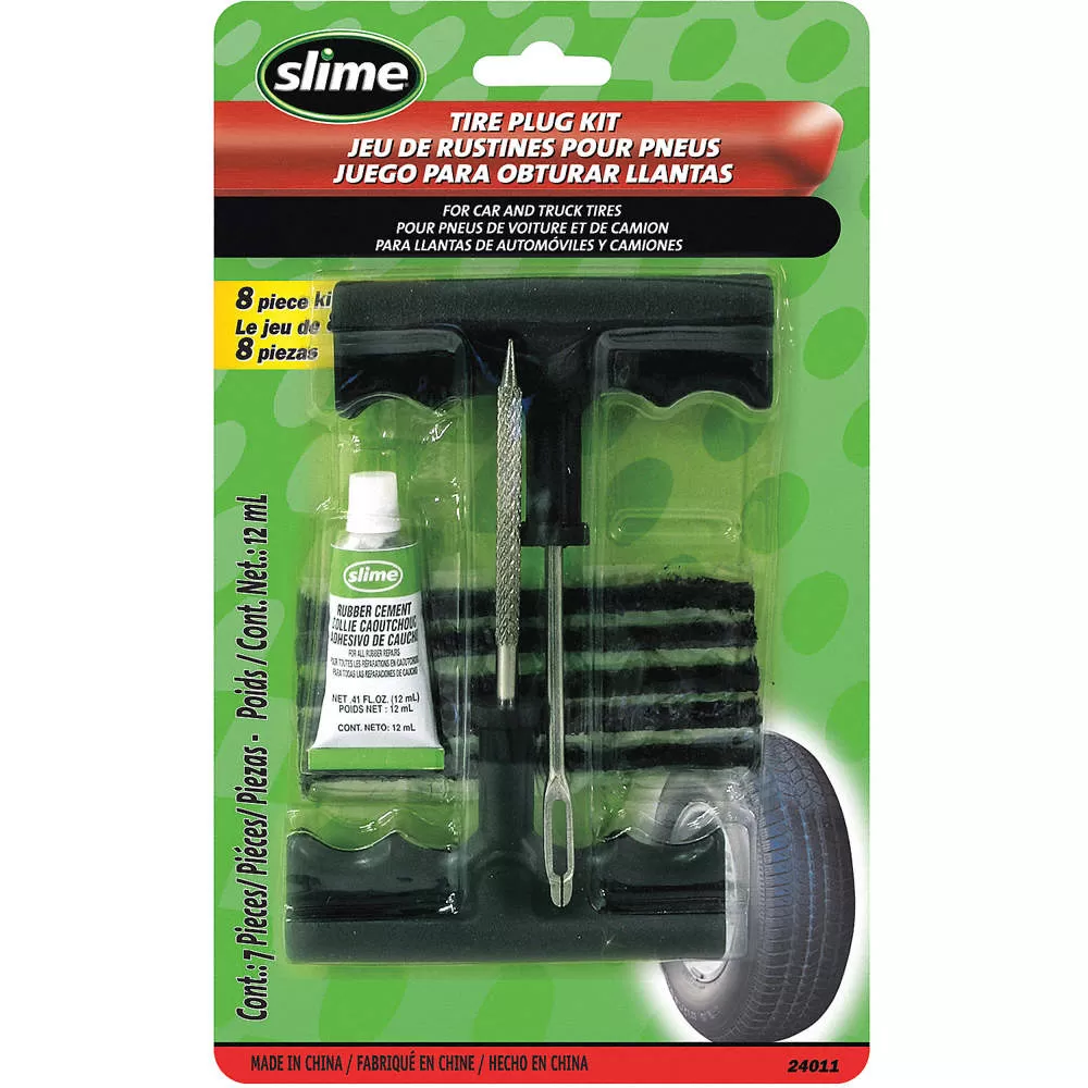

From what I've heard, that goop is generally just sort of a last resort to get the car to the shop and the tire replaced. If you want them to repair it, I'd recommend getting a a kit like this, and just filling it with air through the air compressor that plugs into the car (keep reading below image).

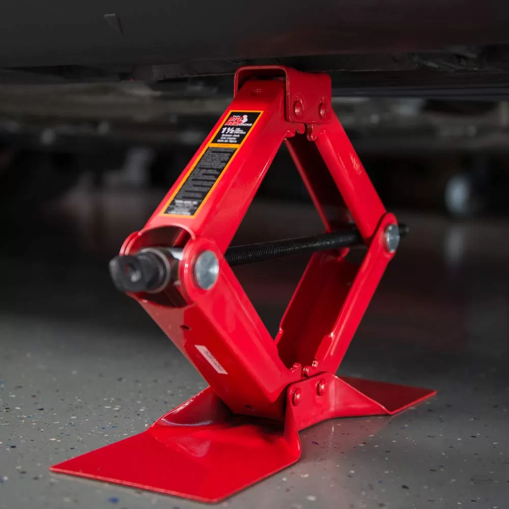

Got the same plug repair kit , still researching a suitable jack . Preferably a small hydraulic rated for 2 tons - not sure about those scissor type jacks. Curb weight is 4000 lbs on the Ultimate. Last thing I need is to have the scissor break and stick into the pack which is literally inches from the jack points.
When I used a scissor jack on the Leafs, it would lift the whole side of the car and Kona's wheelbase is 100 mm shorter than Leaf.

You just gotta remember that when you're jacking up the car, you're not jacking up 4000lb...you're only jacking up ~1/4 of that. Most scissor jacks are rated for 1.5 tons, which is 3000 pounds, so there shouldn't be anything to worry about :)
