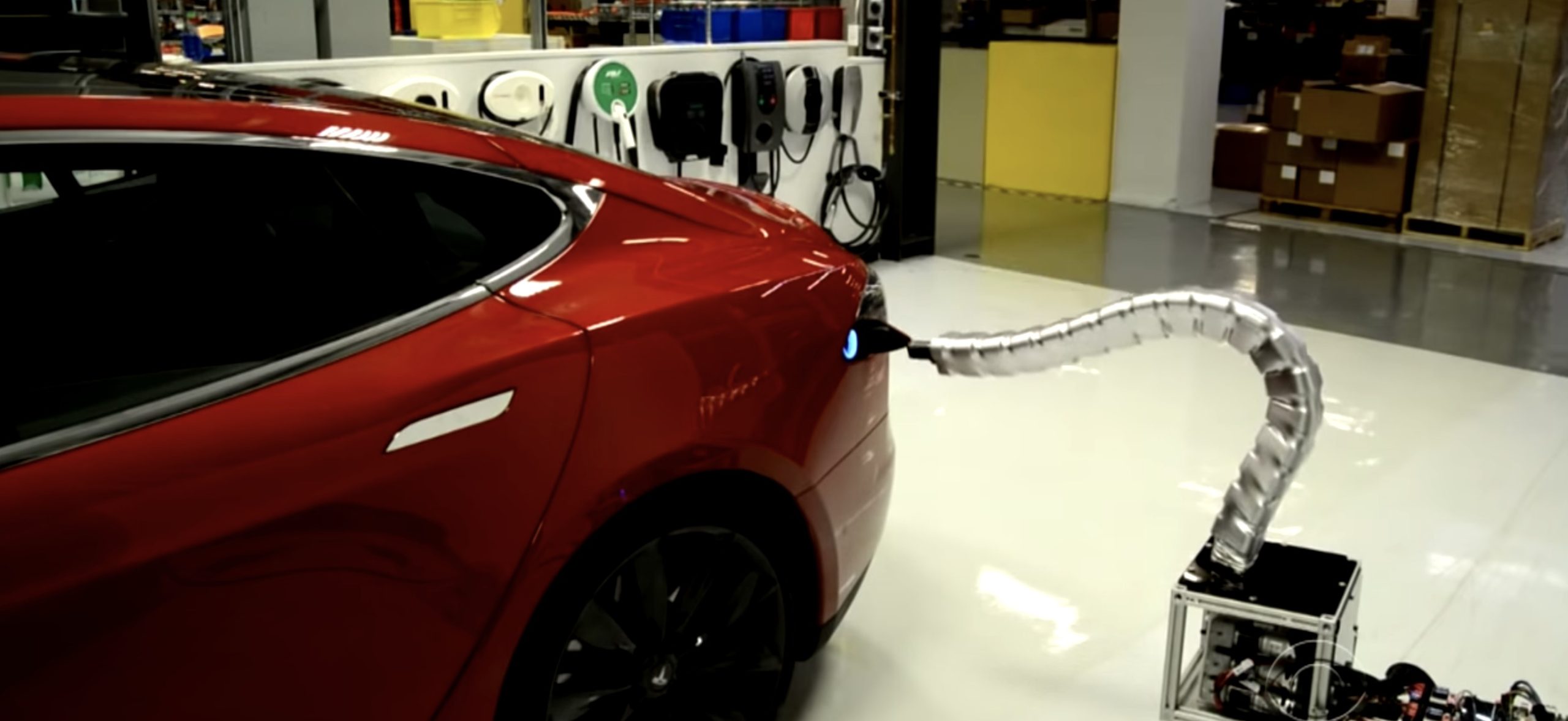

https://insideevs.com/news/338969/automatic-rapid-charging-robot-becomes-reality-but-not-from-tesla/
Also Tesla (non CCS) "snake charger" in the works
Source:
https://www.teslarati.com/tesla-snake-charger-elon-musk/
