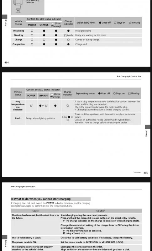

OK so some more information. The box on the charging cable has a solid amber light when plugged in to the wall. It never changes when I plug it into the car. Do you think this is the issue? I think I remember that maybe there is supposed to be a green light on the charging cable transformer when it's charging? Also a while ago I think I had an issue with it stopping charging and I moved the transformer and things started up again - this was a couple of months back. I am going to work today so I will try a charging at 240v, to check if the issue is potentially with the car.
The amber light is the Power Indicator.

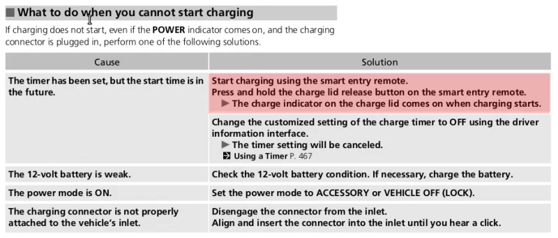

I did try this but i think it tried it incorrectly. I believe I have to open the charge port door by doing this, correct? I just pressed the key when i was already plugged in.... I also plan to check my on-board system to make sure no charge time somehow got set there also...
Although I don't have direct experience, I believe you tried this correctly...
Here is the excerpt from the manual:
I think the intention is that holding the 'charge lid' button (while the charging connector is plugged in) will override whatever timer may be set (either intentionally or accidentally). It sounds like you tried this and were not successful...
