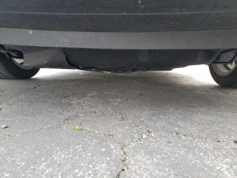

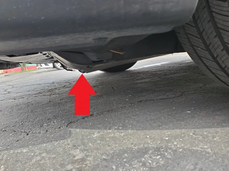

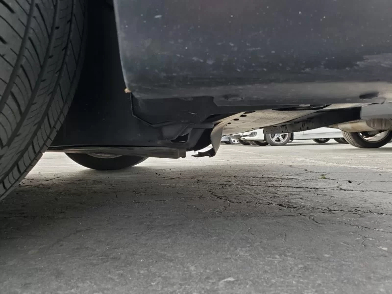

Recently got an oil change. Something seems to be scraping underneath the car when I go up dips in the road and slight ramps.
Is this a case where they just didn't put the underplate back on correctly? Has this happened to anyone else and could there be any extensive damage?
Pictures shown are of the front from the drivers side (with the arrow), the passenger side, and from front of the car

They probably messed up and left a couple of the fasteners out from the engine under panel. The panel could then have sagged down. The panel helps prevent road dirt and debris from getting up onto the underside of the engine. The Honda part number is 90674-TY2-A01. From your pictures, you may need a new panel. I would replace it as keeping stuff off the moving parts (belts, etc.) is important in the long run.
I do my own oil changes. The Clarity is pretty easy. Once the engine under panel is removed, the oil filter and drain plug are easily accessible.
It is a little hard to get the right perspective to be sure that this is a sagging lower engine cover, but that is likely given the scenario with the oil change.
Hopefully it hasn't been damaged too much to simply reattach it. I suggest going back to whoever did the oil change and they should fix it.

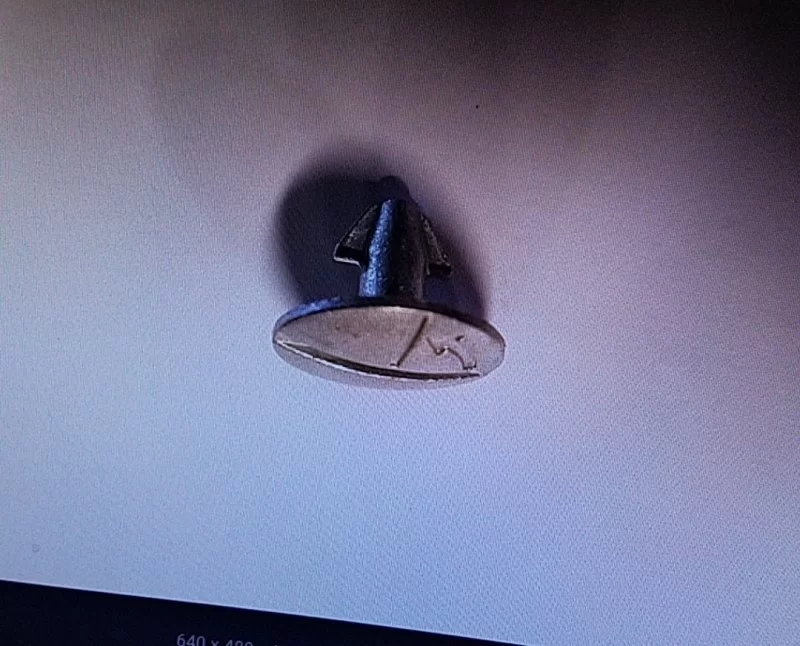

Let me correct something mentioned by @DaleL however... The part number he provided is NOT the panel, but rather the little fasteners. We have puzzled over this panel elsewhere in this forum. The parts diagrams do not show this panel as a stand-alone item, and it appears like it is only available as part of a much larger assembly (that costs close to $300). This larger assembly is 74110-TRW-A00, which presumably includes the panel in question. This is very hard to believe because you might expect to have to replace this "oil-change cover" because it is designed to be easily removed. Here is the previous thread that puzzled over this...

MrFixit is correct. The part number I gave is for the fastener. These fasteners are simple, but sometimes if not installed properly they fall out and are lost. I would first get your car up on some ramps or jack it up (use jack stands before crawling under) and remove the lower engine splash cover. Check and see if it is salvageable. If it is, get more fasteners and reattach it. Otherwise, I would take the cover to a Honda dealer and see if they can order you a replacement cover.

It's literally bang it flat and install new clips/dzus fasteners. The fasteners (and clips) are easy to find on ebay, e.g, https://www.ebay.com/itm/Set-of-10-...-Clip-FOR-Honda-Accord-Civic-CRV/154021301778

I got a second opinion at an independent repair shop. They said that it wasn't damaged a lot so they could reattach the splash guard for just a labor fee and that fixed the scrapping!
