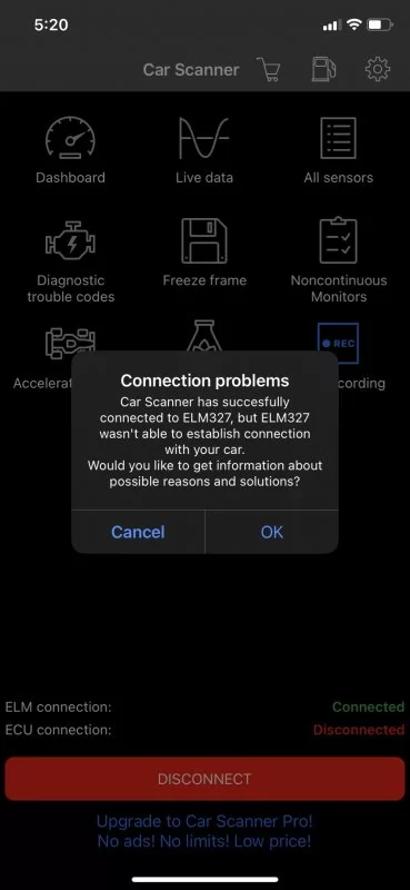

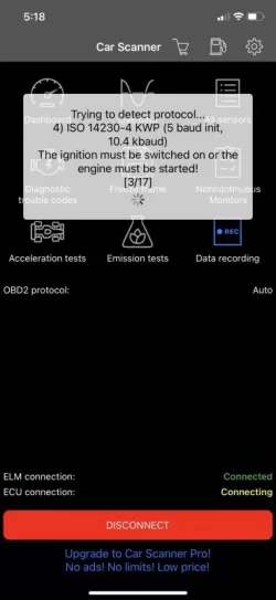

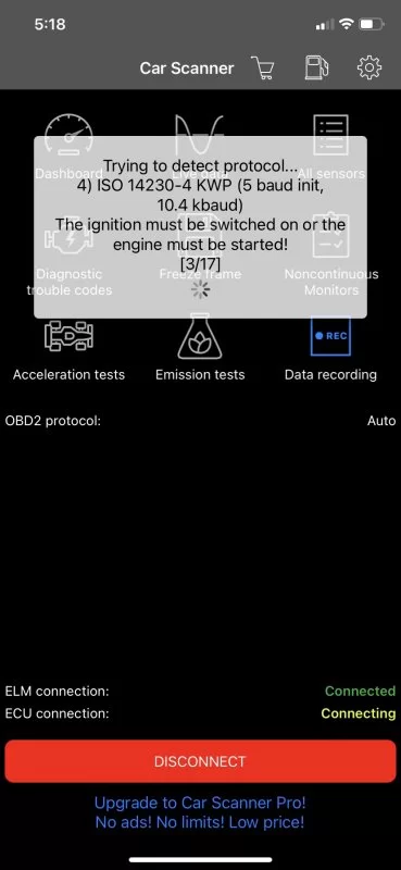

I bought an ELM327 OBDII adapter and installed car scanner on my iPhone. Car scanner has no problem connect to ELM327 but could not connect to ECU. Any one had the same problem? IMG_2423.webpIMG_2424.webp
Not sure which are car scanner recommended adapters but car scanner is the recommended app of this adapter. I suspect some settings I might miss

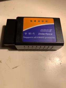

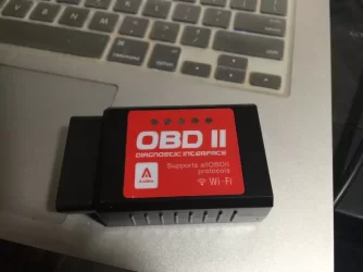

Ok. So this is the OBD II scanner that I am using and it works well with my I phone 6 plus. It puts out a wifi signal as opposed to a bluetooth but I haven't had any problem with it. I just select it under wifi signal on the phone setting. I already owned it so it wasn't purchased with this app in mind put still it works well. I got it off of Amazon a year or so ago.
Very similar. I just tested mine and it worked whether the car is off or on. Just plugged it in and selected the wifi and it connects right up. I have mainly been looking at all sensors and also have checked data recording and all are working on mine. There is much more data available when the car is on obviously. Not sure whats causing your error. Do you have access to a second obd II that you could test it on just to see if you get similar results?

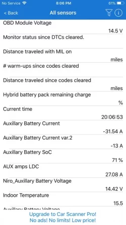

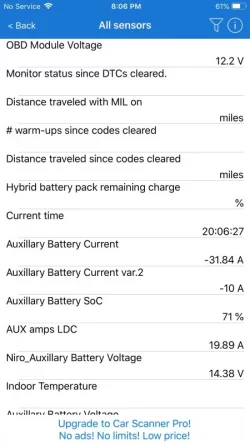

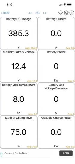

Here are two screen shots. The first is with the car in run the second is with the car powered off. Notice the difference in OBD voltage. First I started car scanner with the car in run. Then I turned the power off for the second reading. Car scanner will not connect with the power off put if it is already connected it will maintain some readings after the car is powered down. I did notice that there was no high voltage or cell readings in the battery pack once it was powered down.
Let me know if there is some thing specific you want to see and I will scroll through the data and post a screen shot if its available.

I was able to reproduce the same error you got. It turns out the car must be in run mode when you first connect to " Car Scanner" If you try to connect with out putting the car in the run mode (ready to drive ) you get the error. To correct this simply press disconnect on the car scanner app, place the car in the run mode and press connect again and you should be good to go.

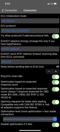

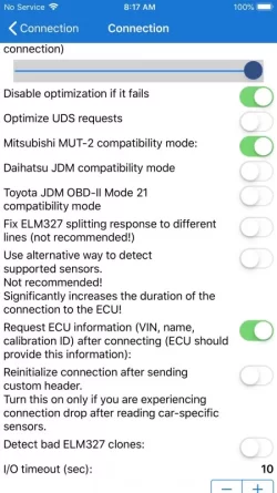

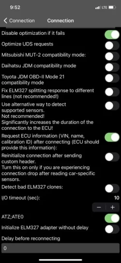

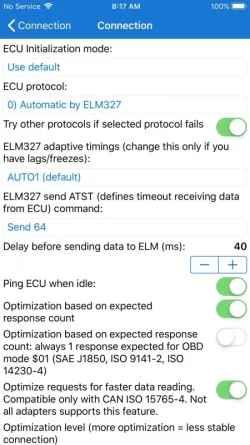

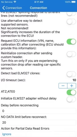

My car was turned on when I did the test. I suspect the connection advanced settings incorrect. I put screenshots here. Are they the same as yours? TIA

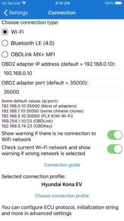

Here are screen shots of all my connection settings. The first page is the general settings , the last three are the advanced settings. looks like there are several differences in our settings hop this helps
fullsizeoutput_2fe.webp fullsizeoutput_300.webp fullsizeoutput_2ff.webp fullsizeoutput_301.webp
I put all settings the same as yours still no lucky. Possibly the ELM327 is not compatible with my car. Any chance you can share the store link of your ELM327? may I need buy it from the same vendor.

I'll just note that the OBD voltage is an analog measurement at the port, not delivered as network data.
