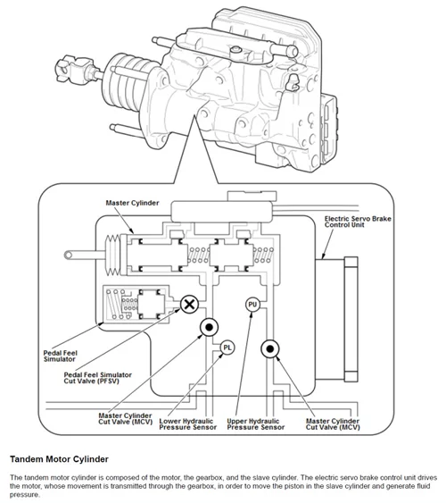

When we returned from vacation, our Clarity's brake disks had acquired a somewhat alarming amount of rust and I could hear a swish-swish-swish sound from the brakes as I drove around town. The sound was especially annoying because our Clarity is otherwise so quiet. When I pressed lightly on the brake pedal, the sound immediately changed to a more pronounced rubbing sound as the brake pads contacted the disks and started grinding off the rust. I was surprised because I expected the Clarity's brake pedal would activate regen braking first and add friction braking as needed to bring the car to a complete stop. However, as long as I was pressing on the brake pedal, I could always hear that the calipers were engaged.
This experience leads me to believe that the brake pedal activates both the brake calipers and regen braking by the traction motor. The extremely complex braking system can then smoothly vary the two methods of braking to avoid a noticeable transition from regen to friction braking.
