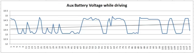

12V battery is on-charge as needed while in 'run' mode. Each tick is 5 seconds. Only the heat pump (or AC compressor), resistive cabin heater and resistive battery heater (all 'as equipped') run off the HV battery. The car will warn you when you are draining the 12V battery when the car is 'on' but not in 'run' mode.
