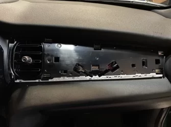

Confirmed, these dash panels just snap out for ‘22+. No collateral disassembly needed. I entered a plastic pry tool from the vent cutout and twisted a bit. I also found a small suction cup helpful to pull near locked clips as I twisted.
There are 8 clips for passenger side (2 towards outside, 2 near the middle, 1 around each of the 4 vent corners.) Drivers side has 6 clips (2 towards the outside, 1 around each of the 4 vent corners.) The accent lighting seems a bit fragile so I did my best to limit prying there.
