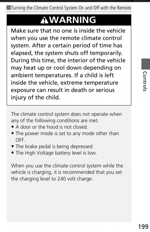

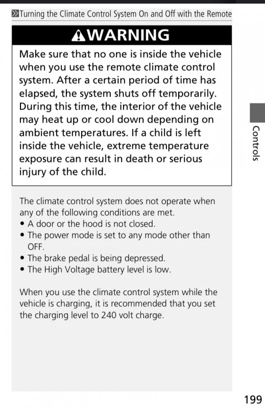

It is interesting that Climate Control would not start until SOC reached 25%. The L2 charge rate, in my experience, exceeds the discharge rate that is applied when using the most demanding CC settings. Charging is going to win the race.
It is mentioned in the manual that CC will be powered by the HV battery if the charge cable is removed. Can the car not charge and operate CC at the same time? Or does it just prioritize charging until SOC reaches 25%.

Operating Climate Control via the Remote/Key fob, can only occur if the Power mode is set to OFF. That condition would prevent the engine from starting.
