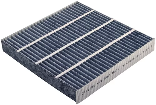

So I called my dealer’s parts dept (go to church w David there so I trust him) and found out that the Clarity CAF cross references with one that fits the 2018 Civic 4 door EX-T (or Ta/TL/TLa). Searching for that I found that the Fram Fresh Breeze CF11182 fits that. It has charcoal and baking soda. It’s $38 to $43 at auto parts stores but only $21 to $22 at Amazon and Walmart (WM temp out).
Link to Amazon:
https://www.amazon.com/gp/aw/d/B00E...am+cf11182&dpPl=1&dpID=51C0iXuNWrL&ref=plSrch
Then I found on Amazon an EPAuto filter CP182 (cross references to the Fram CF11182) with charcoal for only $9. Same number of pleats as Fram (26ish) and w good reviews.
Amazon Link:
https://www.amazon.com/gp/aw/d/B074...am+cf11182&dpPl=1&dpID=514ZnP+NiNL&ref=plSrch
So if you’re a namebrand kind of person order the Fram for $21,save a lot over the OEM and get the benefit of the charcoal. I (being cheap) ordered 3 of the EPAuto ones for $26.91 to get free shipping and at that price, I won’t feel bad about changing them often. Will post on them when they come in.

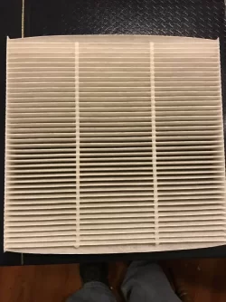

@KentuckyKen Thanks for the find! Did you happen to take a picture of the OEM Honda filter when you took it out? No biggie; sounds like an easy to reach filter.
I've used the Fram filters on my wife's Camry for years. Works well. For whatever reason, the Camry filter is significantly cheaper than the Honda one. Currently listed for $16.92, but I've purchased them for $5.50 each when they had special sales/coupons. The Honda filter does look more robust, with deeper pleats (Fram filter for Honda on left, Toyota on right)

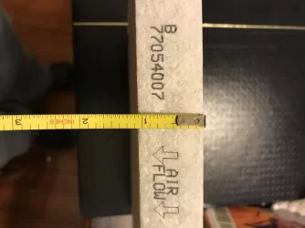

Kendalf, here you are
Also, I had a typo on original post. The Honda OEM in my car has 40 pleats not 30. It’s very well made and the first pix shows the way the pleats are held together. It look like 2 lines of hot melt glue were used. So multiplying the high number of pleats times the 1 1-8” thickness makes for a lot of surface area for low flow restriction. It’s definitely a quality filter and design.
The filters with activated charcoal will necessarily have to have less pleats since the media is thicker. When new filters come in, I will give them the old Mark 1 Back of Hand Air Flow Test to see if there is a noticeable loss of blower output. If so, then they get returned and I try the Fram and if that’s restricted too, I go back to OEM and give up on the charcoal.

I don’t think you can compare CAFs from other cars since the different mfgs call for different sizes and thicknesses for their respective models. So thickness/thinness is not representative of quality except within one model’s application. This also partially explains the difference in prices. Surface area (number of pleats) and flow rate are what’s really important since I suspect any decent quality CAF will have appropriately the same particle capture. I haven’t seen any reputable testing of CAFs for particle size capture like there is in house HVAC filters. Only thing we know for certain is that charcoal is great to have as long as it doesn’t restrict the airflow significantly.

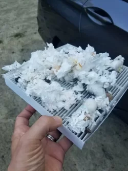

Thanks for posting this - this is what mine looked like when I took it out after finding a dead baby mouse on the passenger floor mat. Any leads on a mouse deterrent version?

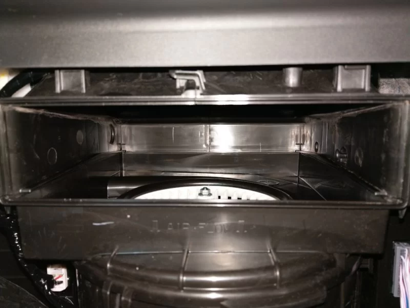

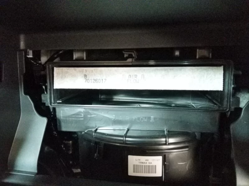

Those who replaced the cabin air filter yourself, did it look like this when you removed the cover?
Almost seems like it's missing a filter tray or something, as the filter simply slots in with no support beneath. I've never seen a car that had this empty space under the filter. If that's the way it's supposed to be, I wonder if the Fuel Cell version has a different air cleaner element that fills the whole space. Otherwise, I can't imagine what the purpose of having this air gap is.
Yes it does look like that. It was exactly the same design in my 06 Honda Civic Hybrid also. Once the cover is back on the air gap is sealed off.
