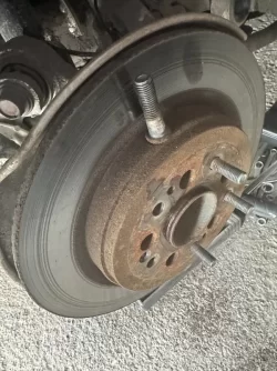

Looks like a broken stud? Should be a relatively easy fix if you have the right tools, and not horribly expensive if you don't.

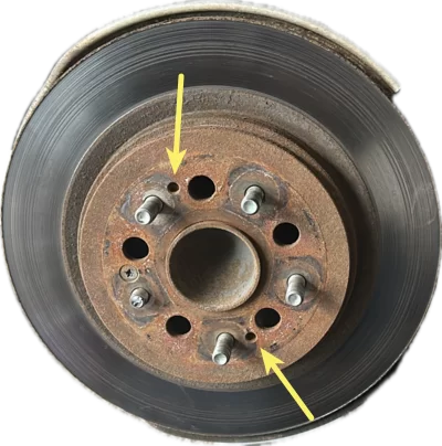

I recently found that a small impact driver (the ones that essentially look like a drill) does an excellent job of removing the small screw holding the disk.
Also - to remove the disk, the two holes (marked with the yellow arrows) are threaded for 'jack screws'. You can thread bolts in these and use them to jack the disk off of the spindle. If it is really stuck badly, sometimes hammering in addition to the jack screws is necessary to break the rust...
OK, all done.
If someone will have to do the same-
no need to remove philips bolt, do not remove disk and/or breaks - unnecessary.
Enough space there to kick out the old studs and insert the new one (you may have to ask for help someone with more flexible fingers not sausages)
