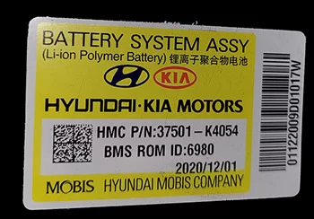

There's a date on a sticker underneath my 2021 Kona, just forward of the rear wheel. Not sure if it's the manufacture date of the pack, but it's not any earlier than that.
There are other labels, but on my car they are tucked up behind the left rear suspension on the rear-facing edge of the battery pack, and don't have additional date information (unless it's in Korean).

Or would we prefer to know about the part number? A battery dated 11/18/19 was 37501-K4051. My battery (12/1/20) is 37501-K4054. At some point the battery type was changed "offering more energy density with less weight and volume (slight chemistry alteration)."
It might be helpful if people who answer the poll could post both the date and part number. Again, the sticker on my car is on the bottom of the battery pack, just forward of the left rear wheel.
