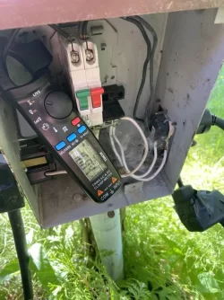

EBD5E302-4E15-4230-91CD-E642F408E87E.webp FF3D8515-65AC-43AA-A1A8-A0FD005FB25E.webp On a hot day when I use a/c breaker trips without any extra load (no clarity charging, I kill all the lights, fridge, etc). My measurement yesterday showed that a/c eats only 12a - but this is enough to trip 30a.

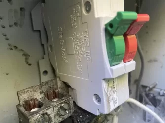

Looked at the breaker, indeed it says on the side 40 celsius.
Will measure temperature inside the breaker box today, will be hot here.
On the pic is the load when I have a/c plus all other load in the trailer. (No car charging).
My breaker is the green one on the left.

Do you own this box? And are you an electrician? It seems to me from your questions and comments that the answer is likely no to both. That appears to be single phase? Based on 1 wire coming out of breaker I'm now assuming this is a 30 amp 120V circuit and this is not a 240V circuit as I had previously assumed from your 30 amp comment. There is just not enough info to go on here for anyone, so my last and most significant piece of advice is to close it up and ask the owner of the box to send an electrician to troubleshoot this issue. You need a proper test equipment and experience in how to use it to troubleshoot RV park wiring, which can be different form residential, to determine what is causing your problem. Sorry I don't have RV park wiring experience so unless I'm on-site with a meter to figure out exactly what kind of power is coming into this box, what gauge the wires all are, and see more clearly how they've distributed it to the outlets, I can’t help further...
My honest suspicion is that you're asking this low amperage box to simply do too much. That is a small box even by RV park standards. Many modern trailers could not run off of that. There is simply not much there to run an entire trailer AND charge your car...I guess one more piece of advice: I'd seriously consider running your Clarity on gasoline if they can't upgrade that service box for you. But upgrading that box is probably going to require major investment of trenching heavier gauge wire from their distribution area all the way to your site...
I've refused to install car chargers for customers in residences with 100 amp service. So I can't recommend even attempting to charge a car from a residence that has 30 amp service...which is what I believe you have here.

One last question I guess. You still haven't advised if you're L1 charging or L2 charging. I have to assume L1 because I don't see any 240v breakers there in your pic:
You have a 20 amp circuit right there in the same box. If you plug your car into that 20 amp circuit instead of the 30 amp, does it charge fine? Same question for your A/C, which I now have to assume is a 110V unit. L1 charging only draws about 12 amps...many people are charging their cars L1 on 15 amp circuits which are common in homes, so you sure as heck don't need a 30 amp circuit to charge a car on 110V, nor do you need it to run a 110V A/C unit on an RV.
I think there could be connection issue(s) within the box itself, and an electrician will likely be needed to sort it out. Poor connections will generate heat and could cause a breaker to trip, and from the looks of the box, it is not weather tight and corrosion could be a factor. They'll probably also correct code violations like the double tap on the red handled breaker.
The Stab Lok breakers (and panels) are also problematic, but usually the issue is failure to trip.
https://www.redbudinspections.com/dangers-of-stab-lok-circuit-breakers/
https://blog.societyinsurance.com/why-you-should-replace-federal-pacific-stab-lok-panels/
Has to be L1. A 30A RV service is a single 120V leg that provides 3600 watts of power. There appears to also be a 15/20A duplex outlet at the pedestal.
It also appears to be “vintage” and not the most professional of installations.
