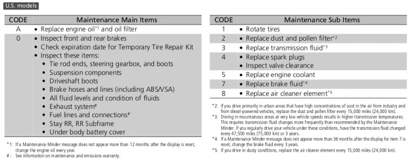

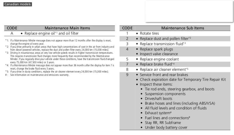

So what should ask to make sure that they will do the appropriate service and not some ´inspection’ bs?
thanks
For appropriate service you should ask them to remove and lubricate the caliper pins to ensure proper operation, and to break the pads loose from the calipers to make sure they are not rusted in place, and obviously to make sure they’re not worn.
