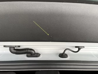

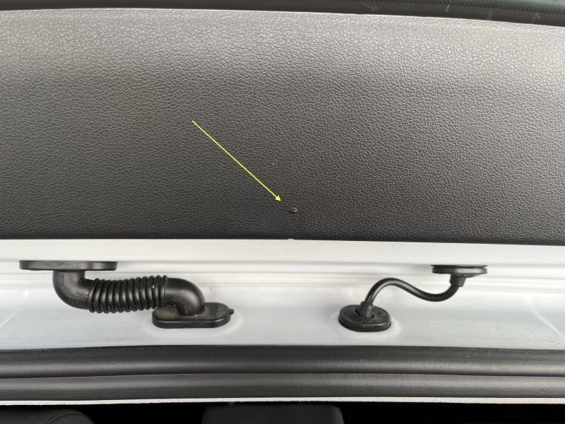

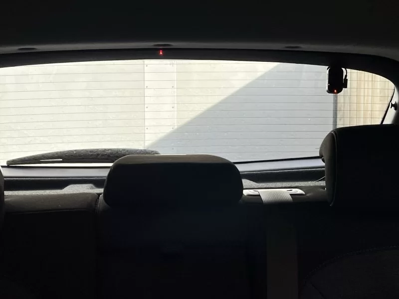

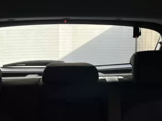

Because it was easy I installed an LED indicator in the hatch area upper opening to indicate when the brake light is "on". Much to my surprise the light does not stay illuminated after stopping with the left paddle, an issue raised in 2018 by numerous owners including The EV Puzzle on YouTube, and one I thought had been corrected with a software update in 2019. So, I've been driving around for 4 years assuming this boneheaded design error had been corrected.
The 3mm LED has been tapped into the centre brake light via (2) 220 ohm resistors.

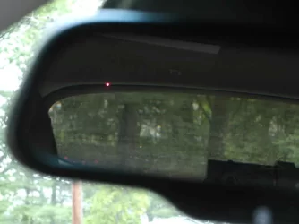

That's a great idea! I did the same thing when I couldn't stand not knowing when my MINI Cooper SE was deciding to illuminate the brake lights in response to regen braking. The interior brake LED has helped me modify my driving style a bit to minimize frequent flashing.

Yes, that's essentially the same mod, and for identical reasons. I also initially placed it too high to be visible and had to lower it and patch the original hole with epoxy. I've only driven 10 minutes with it so far but it's very useful to know what signals you're providing following vehicles.

I bought a handful of 3mm LED types from the local electronics hobbyist chain store and tested them for brightness and current. I settled on one rated for 40 mA maximum and then sized the resistor (2 x 220 ohms) for 31 mA.
If anyone needs better photos I'm not adverse to pulling it apart and providing those.
I had a telltale in the 2019, poked through into the instrument binnacle near the power/regen meter and
tapped into the brake light wire at the chassis connectors under the kick panel. I never duplicated that
in the 2021, but that looks like a somewhat easier way to do it, and may even make more sense in terms
of road sightline. I'm frequently checking what's behind me while braking anyway, to make sure people
are paying attention...

This and the other thread / youtube about this inspired me to add a brake lights telltale again, in Kiwi's
elegant style, but poking through the trim near the left end instead of the middle. This puts it closer to my
normal sightline at minimal visual displacement across the rearview mirror.

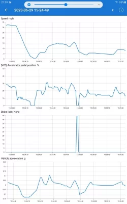

Using iPedal on my EV6, this image (using Car scanner Pro) shows what happens when you feather the go pedal (left of image), and when you take your foot off the go pedal completly. (right of image).
