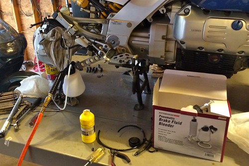

As an aside, I once had a heck of a time bleeding the brakes the conventional way on a motorcycle after replacing the brake lines with stainless lines. Eventually sprung for a $30 kit from Harbor Freight that pumps the fluid in “backwards” from the bleeder valve using an air compressor.

The thing I have heard of that seems akin to this is an arrangement using an air compressor to push fluid through from the master cylinder end. You connect the air compressor to a surrogate filler cap on the master and when you open each bleeder valve, the fluid just comes out without having to pump the brakes. Could that be what the Harbor Freight tool was doing?
Or, you can use a vacuum to pull fluid out of the bleeders (keeping an eye on the level in the master as you describe). I just looked at Harbor Freight, and they do have a tool to pull fluid out of the bleeders like this (using compressed air to create the vacuum instead of a hand pump).

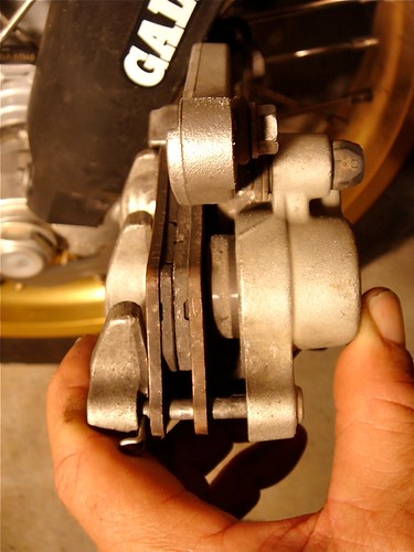

This is the grit that should be cleaned off before pushing the pistons back into their bores (on a KTM motorcycle):
