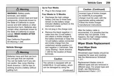

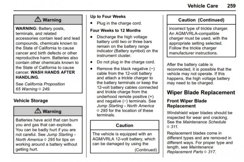

Never mind. Found the answer on page 259 in owners manualDoes anyone have any recommendations on storing the car for 2-3 months? What would be best to not damage batteries?

Just to report back on this; I put my Chevy Bolt in storage for 6 weeks over Christmas and had no problem. The trickle charger I used kept the 12 battery nicely charged. When I returned, I disconnected the AGM charger, plugged in the car's HV charger. Everything charged back up with no problem, and I was on my way.For longer than 4 weeks, discharge the HV battery to 2-3 bars, and trickle charge the 12 volt battery while you are away. Leave the car unplugged at the charger port.
