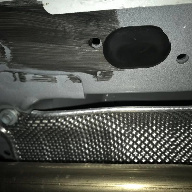

This is in regards to the recent Predelivery inspection checklist post where the 4 x Body plugs were noted to be missing on several forum members' vehicles.
I just had them installed at the dealer (they mentioned that some of the claritys did not even get delivered to them with this part).
Pictured are the Front and Rear plugs. They fit the shape properly.
There are notably many more "holes" in the tube / hollow framing.

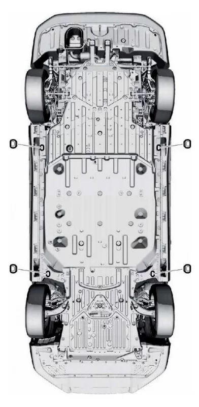

They are located behind the jack points (towards the middle of the car) a few inches inside the wheels. They are difficult to see, have to really get down low.

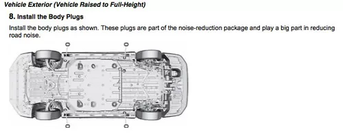

The plugs come with the front license plate holder kit. They are supposed to be installed by the dealer as part of their PDI, since the holes are used for transport. There is a thread that shows the whole PDI and includes the locations. It's easier to see the front ones.
Yes, almost impossible to see. The front two weren't too bad. I could actually see them. The back ones I would say are impossible to see unless the car is jacked up. The PDI PDF (https://www.insideevsforum.com/community/index.php?attachments/clarity-pdi-pdf.1713/) shows where they are. I had to use my phone to take a picture because I couldn't wedge my head under the car far enough to see them. :-)

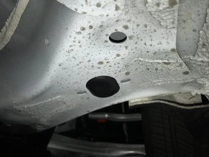

Old thread, I know, but I just checked the tire pressures on the Clarity we picked up yesterday and they were all in the vicinity of 45 psi. Took them all down to the specified 36 psi. Going to go look for the plugs now.
edited to add: Yep! All there.
For reference:

I just passed my cell phone and hands under my car and it seems as if the plugs are not there. All I see (and feel) are a few oval looking holes. I assume that those are where the plugs should go into?
Yes. I found the holes relatively easy to spot, lying on the ground with a bright flashlight and guided by the illustrations provided here. And mine were in place, BTW.
