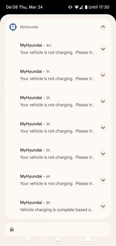

I'm charging my Kona overnight on a Grizzl-e "smart" EVSE. I get a notification when it's fully charged (80%) and then wake up to a screen like this:

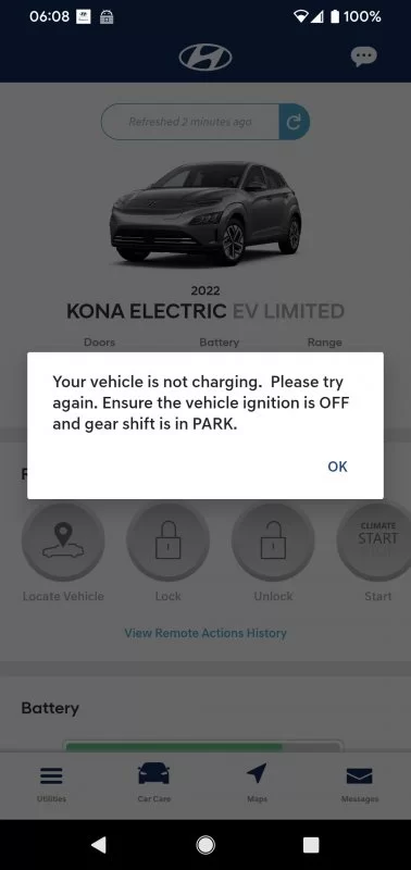

Clicking on one of them opens the app with the following:
"Your vehicle is not charging. Please try again. Ensure the vehicle ignition is OFF and gear shift is in PARK."
Any idea what it all means?

I get a similar experience when charging at home overnight. As you look at that screen, the very bottom said "Complete based on your charging setting". The subsequent "Not Charging" messages are just saying that your car is Plugged in, but Not Charging (anymore). Something (stupidly) changed in the BLUELINK system several month ago (?) that seems to reporting this now. for instance, for MINE, I start charging at midnight. An 80% charge takes until 06:30 in the morning. If I leave it plugged in after that, I get exactly those same "NOT CHARGING" messages, after the initial "Charging Complete". So bottom line, I think it's just an information message ... Maybe re-check your charging schedule/settings ??
