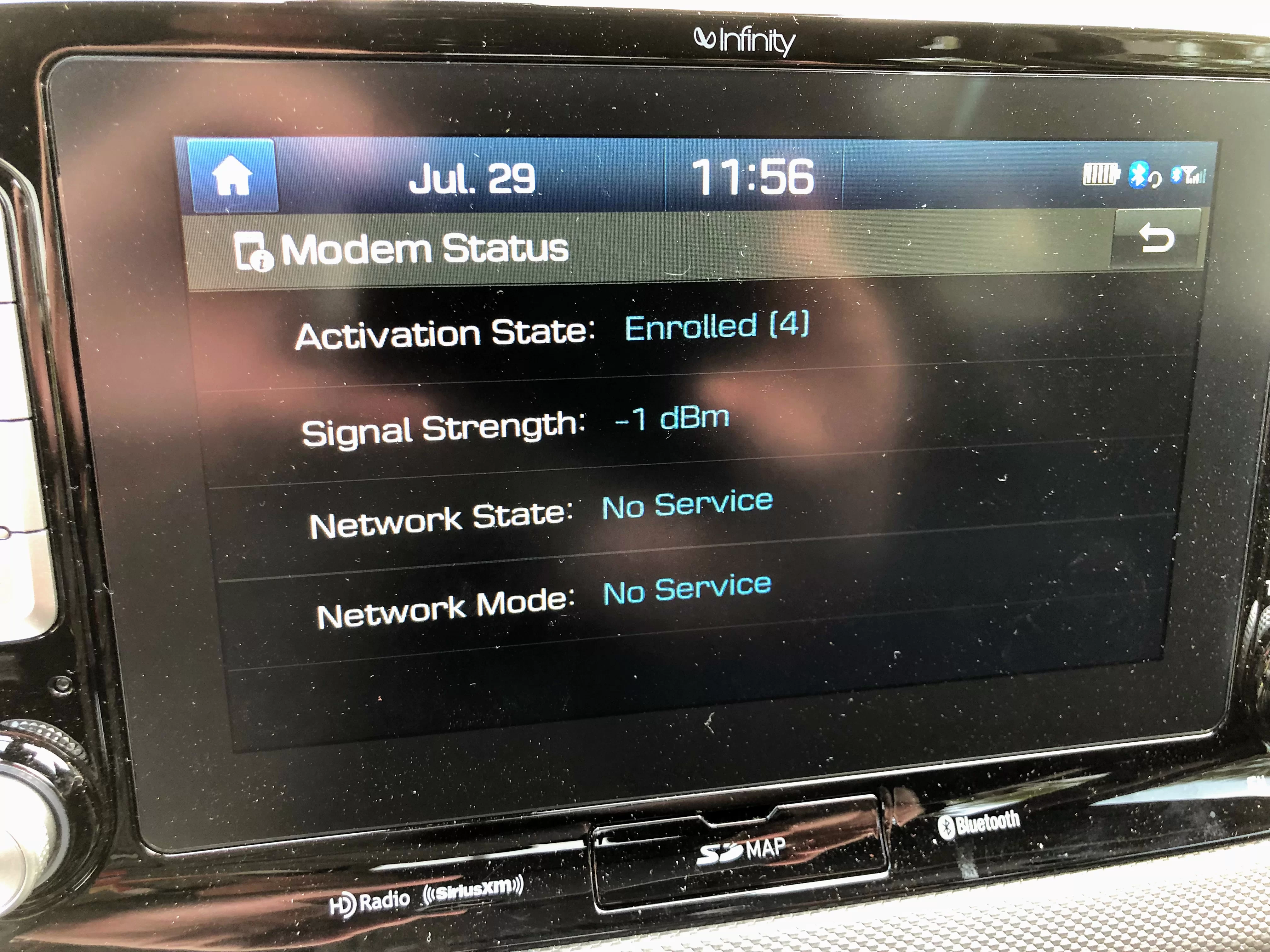

The app and web portal has not been able to connect to my Kona since Friday July 26. Anyone else have this problem?
In car it shows the modem status as:
Network State: No Service
Network Mode: No Service
Thanks for the updates everyone. Looks like my Kona's LTE modem bit the dust.

Totally forgot about that reset button, glad it worked for you. Should have no fear now if mine does the same. Does the Media info screen show different than this picture you posted? (new photo would be awesome):
