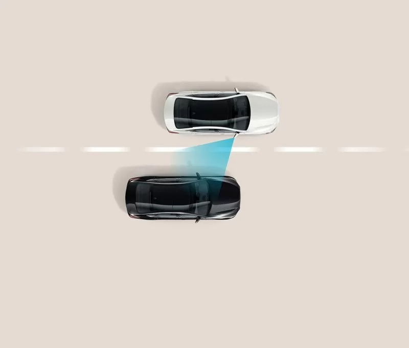

I'm having inconsistent BCW when I have had cars in my blind spot because i catch one in a partial shoulder check [peripheral vision],and NO indicator comes on on the HUD [ peripheral vision]. When I remember,and I am bored in traffic,I am actively watching for the BCW as vehicles come into range. 18 wheelers, the BCW will detect if it's behind me,but if it's changed lanes,coming parallel to me like the Hyundai picture,no,despite the size of the truck.
Supposedly it's supposed to come on at 30km/18miles.

View attachment 6506 View attachment 6504

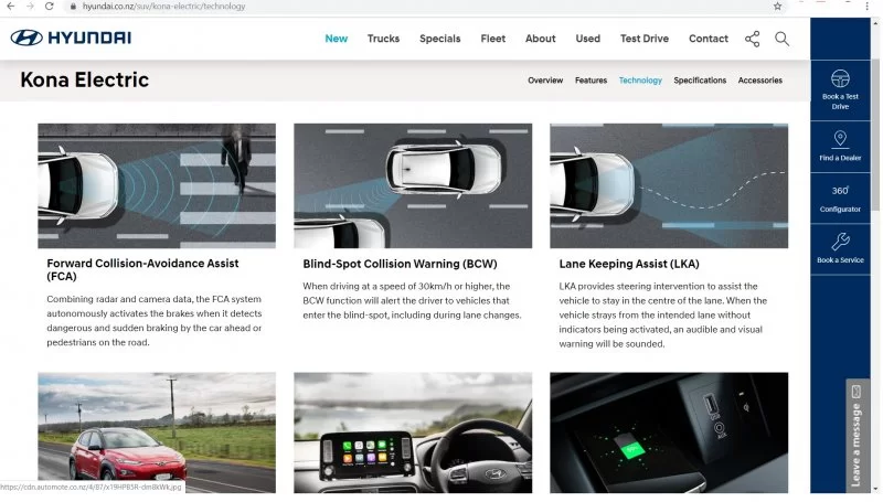

Where did the second picture come from showing detection off the mirror?
When I check the website shown the detection is off the rear bumper as described in the manual:
https://www.hyundai.co.nz/suv/kona-electric/technology
