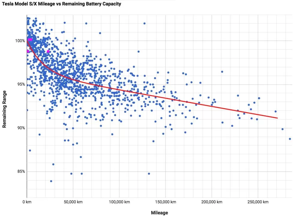

There is an initial loss if capacity that soon reduces to a shallow slope until the end when it accelerates again. The literature clearly shows the pattern:
https://batteryuniversity.com/learn/article/how_to_prolong_lithium_based_batteries
Tesla specific: https://electrek.co/2018/04/14/tesla-battery-degradation-data/
