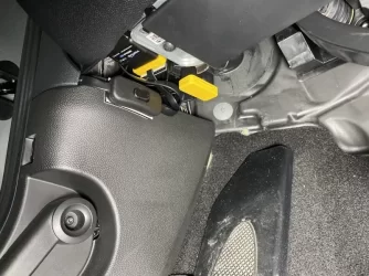

In fact, I have been using it with ABRP often enough that I recently installed an OBD cable with an on/off switch so I don't have to worry about removing and reinstalling the adapter for battery drain or security concerns:

Do you turn it On/Off every time you get get in the car?
Only when I intend to use it (and remember). I did so consistently for about a week to help ABRP "learn" my SE's consumption under various conditions. As with many things, it can become muscle memory with enough practice. If I were to do it all over again, I would have spent more time finding a higher mounting location for the switch so it's a little easier to reach.
I used 3M Scotch "extremely strong" interlocking fasteners like these to mount both the switch and the end of the cable I plugged the Veepeak into: https://www.amazon.com/SCOTCH-Fasteners-Extremely-Strong-Holds/dp/B00347A8GM/ That will allow me to easily remove the cable & adapter (e.g. before a service visit) and just as easily put them back.
