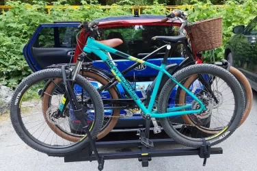

hi - I know this thread may be old, but I've done this. I had a trailer hitch installed into my 2021 Kia Soul EV, by a reputable local installer, and put an e-bike rated rack from Costco on the back.
