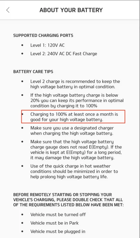

Kia says to charge to 80%
But then they also say this...
This can go on for pages and pages...

If you are asking me, my recommendation was to 100% no matter what. (next to last paragraph in my post)
I have no "battery charging angst" :D
So if I happen to drive a bit farther and the battery is depleted to 14% I should then charge to 100% instead of 80%?
No idea, but for me I'd just charge back up 80%. Then every 2000 miles or 2 month, I'd charge to 100% at least once. Kinda taking the manuals advice of monthly charging to 100% at least once.
