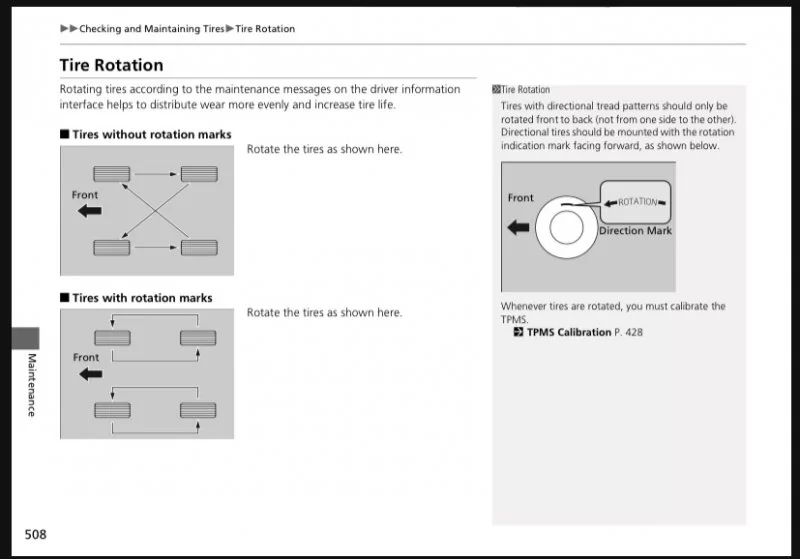

D6B76E9F-8809-4A96-94F6-F3A0681A5234.webp These are the recommended tire rotation patterns shown in the manual. Which pattern do you believe your dealership is using?
View attachment 13794 These are the recommended tire rotation patterns shown in the manual. Which pattern do you believe your dealership is using?
They might not have used any pattern and just switched 2 wheels they took off for the annual state inspection and said done. It couldn't have been the pattern in the top diagram because both my front and rear passenger side tires at the time had unique curb rashes from parallel parking making them easy to identify and my front passenger side tire was on the driver side after the rotation. I didn't question it at the time because I figured they were a Honda dealer so they should know more than me.
