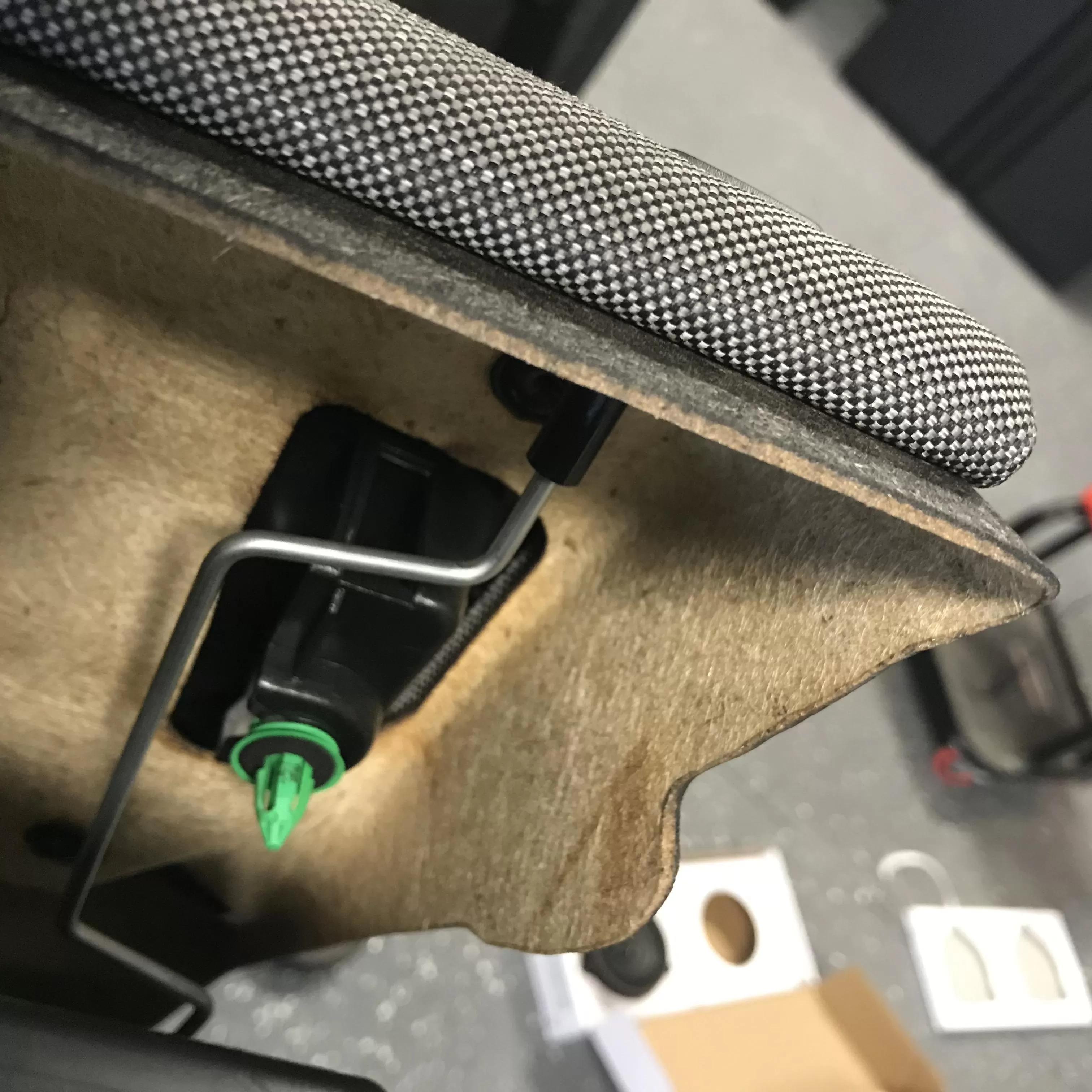

Don't forget to align the push-button lock rod thingy on your door with the hole in the door. I accidentally forgot on the passenger door and had to take it apart and put it back together. I did it faster than it took my kids to pee. Dropped them off in the garage and by the time they came back out, I was done. It was quick once you know how to do it.

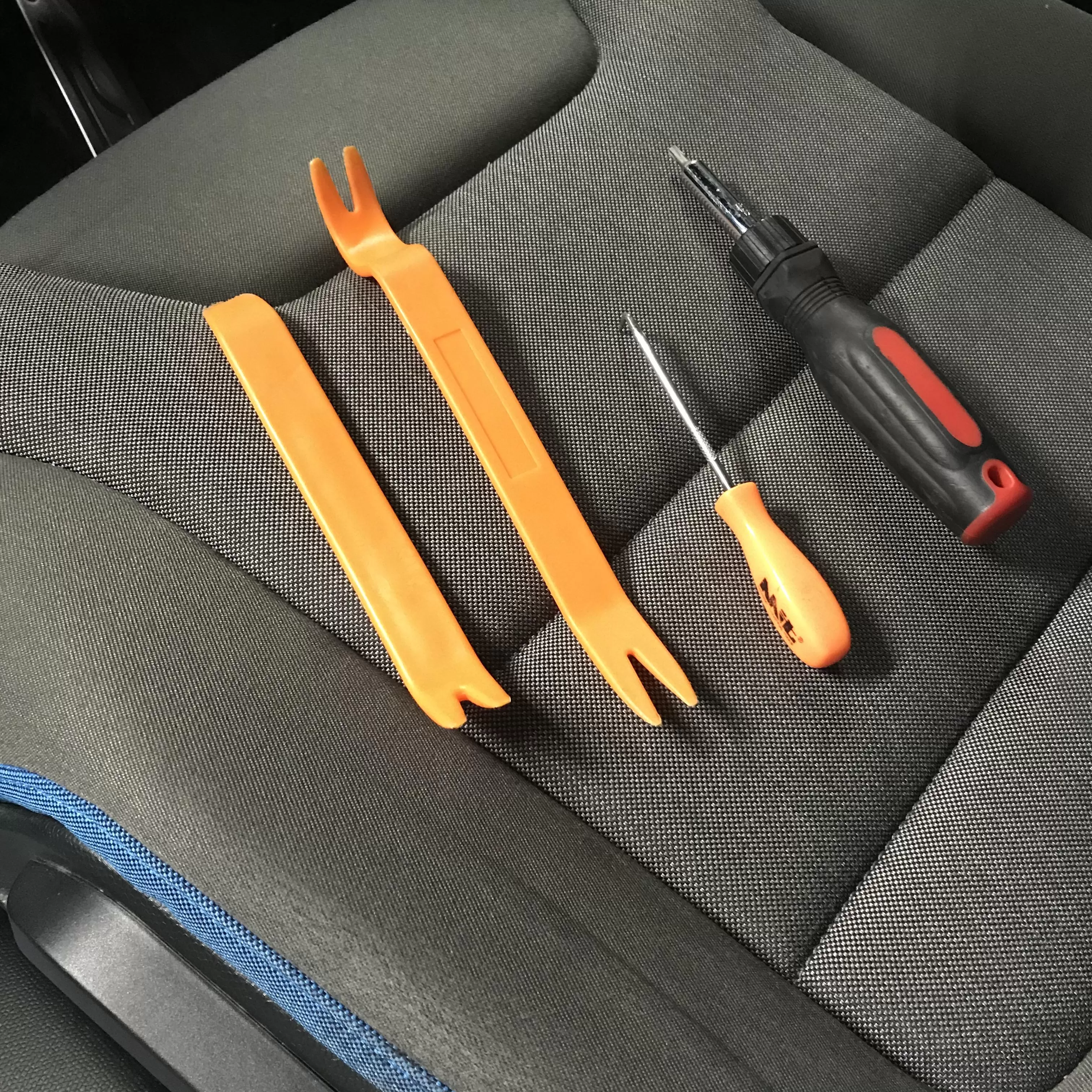

Before you start, get your tools together. These plastic wedge tools can be had from Harbor Freight or Aliexpress for cheap. I believe Bavsound sells an installation kit as well.

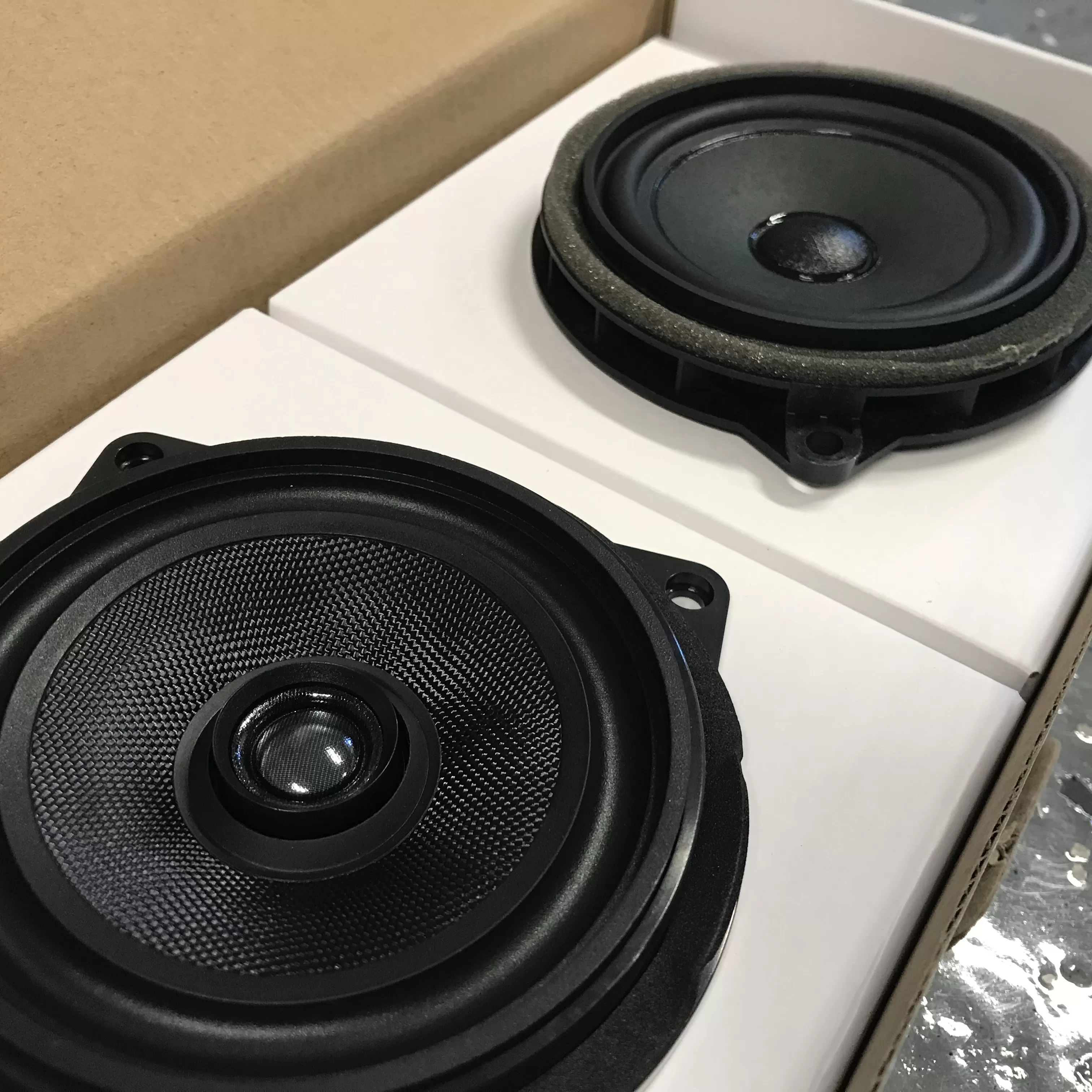

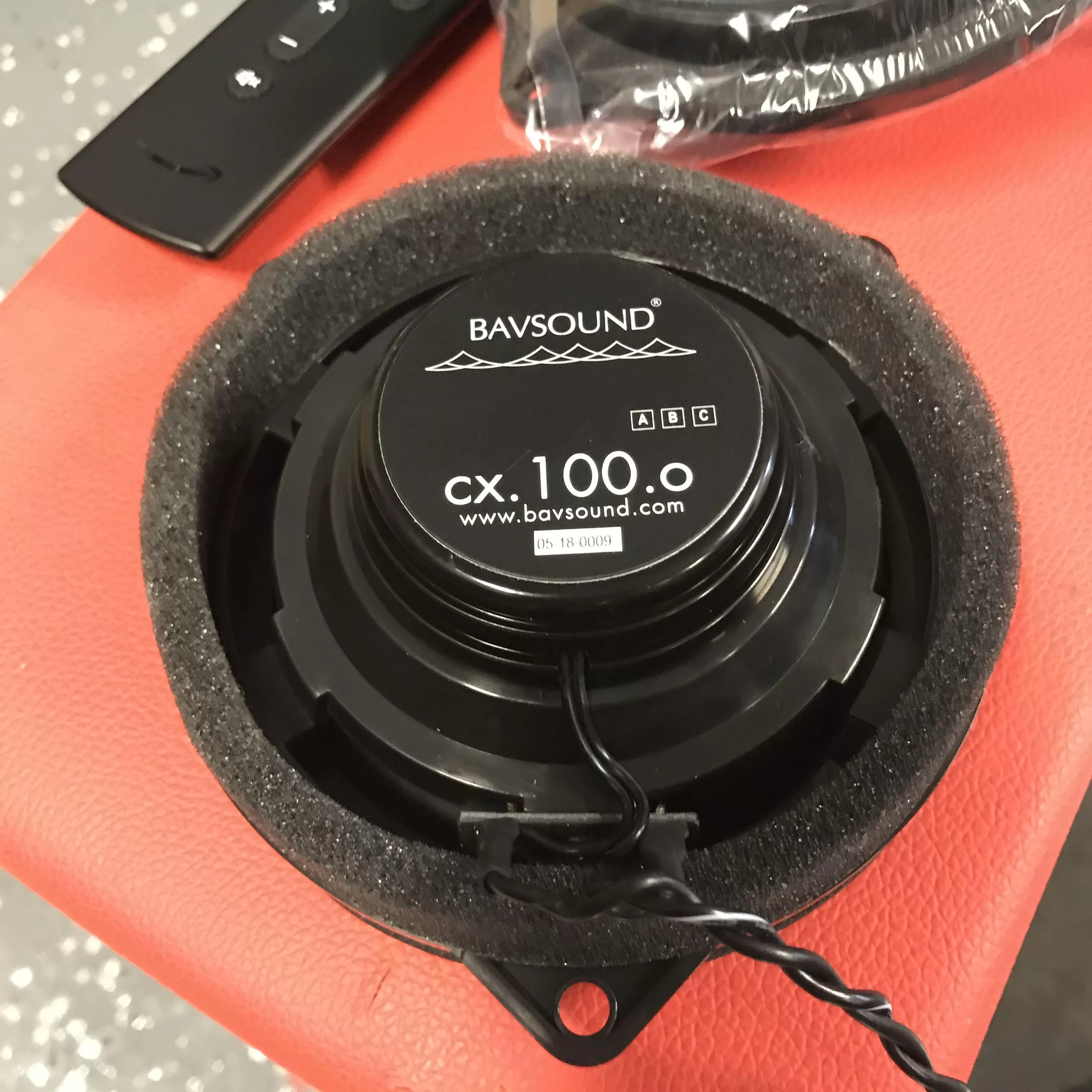

New speaker in the foreground and the stock paper one in the back:

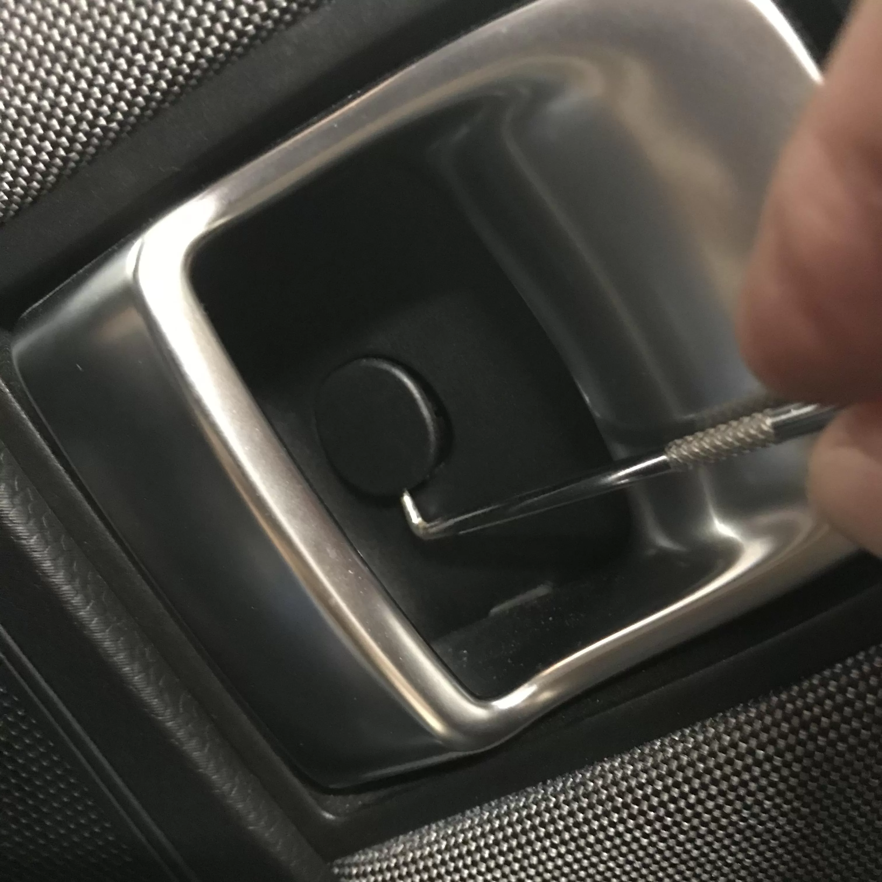

You'll need a tool to access the little circular cover plate that covers the screw which attaches your door in place. Snap that off but be careful not to lose it. Just put in the BAVSOUND box and you'll be well organized:

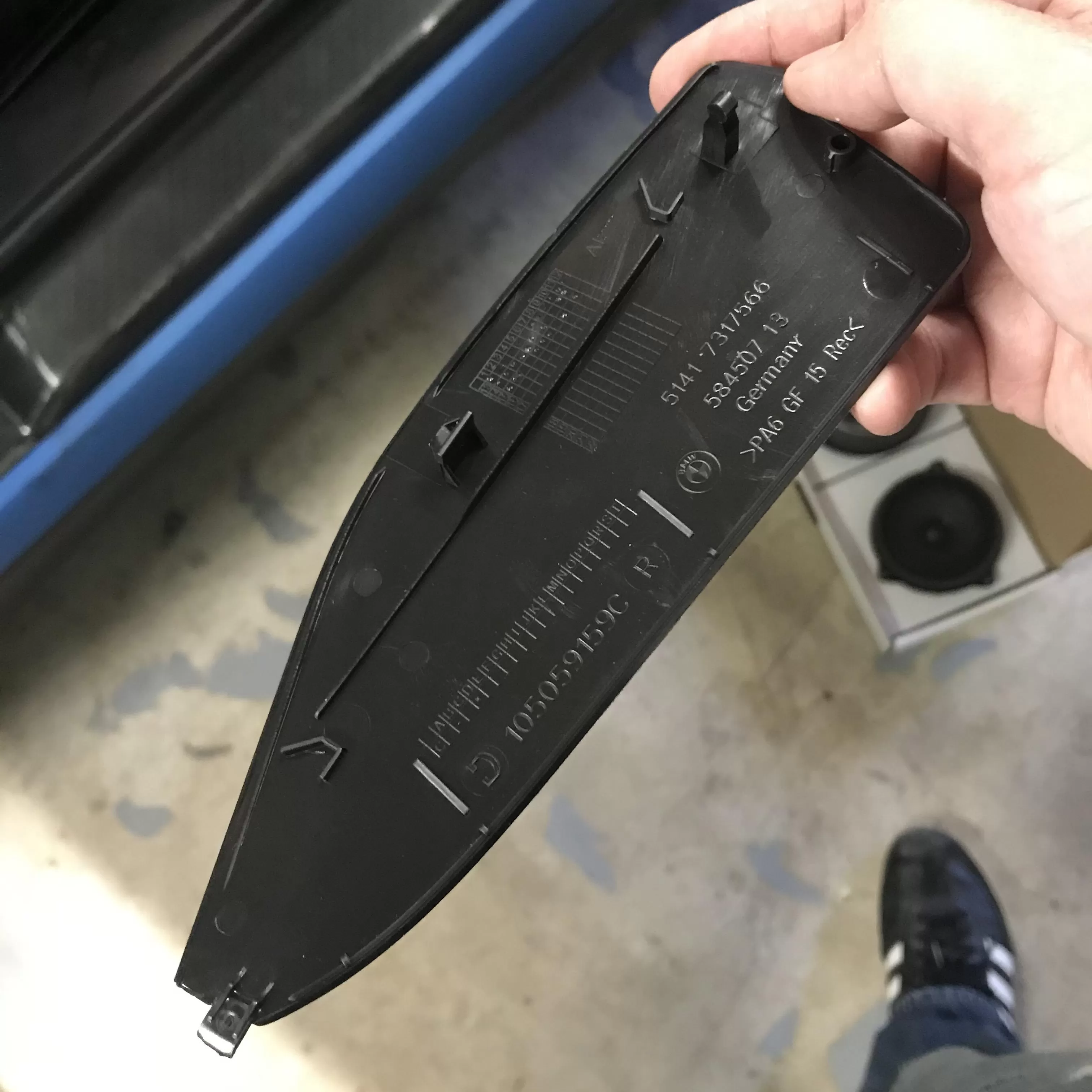

The piece that comes off is shaped like this:

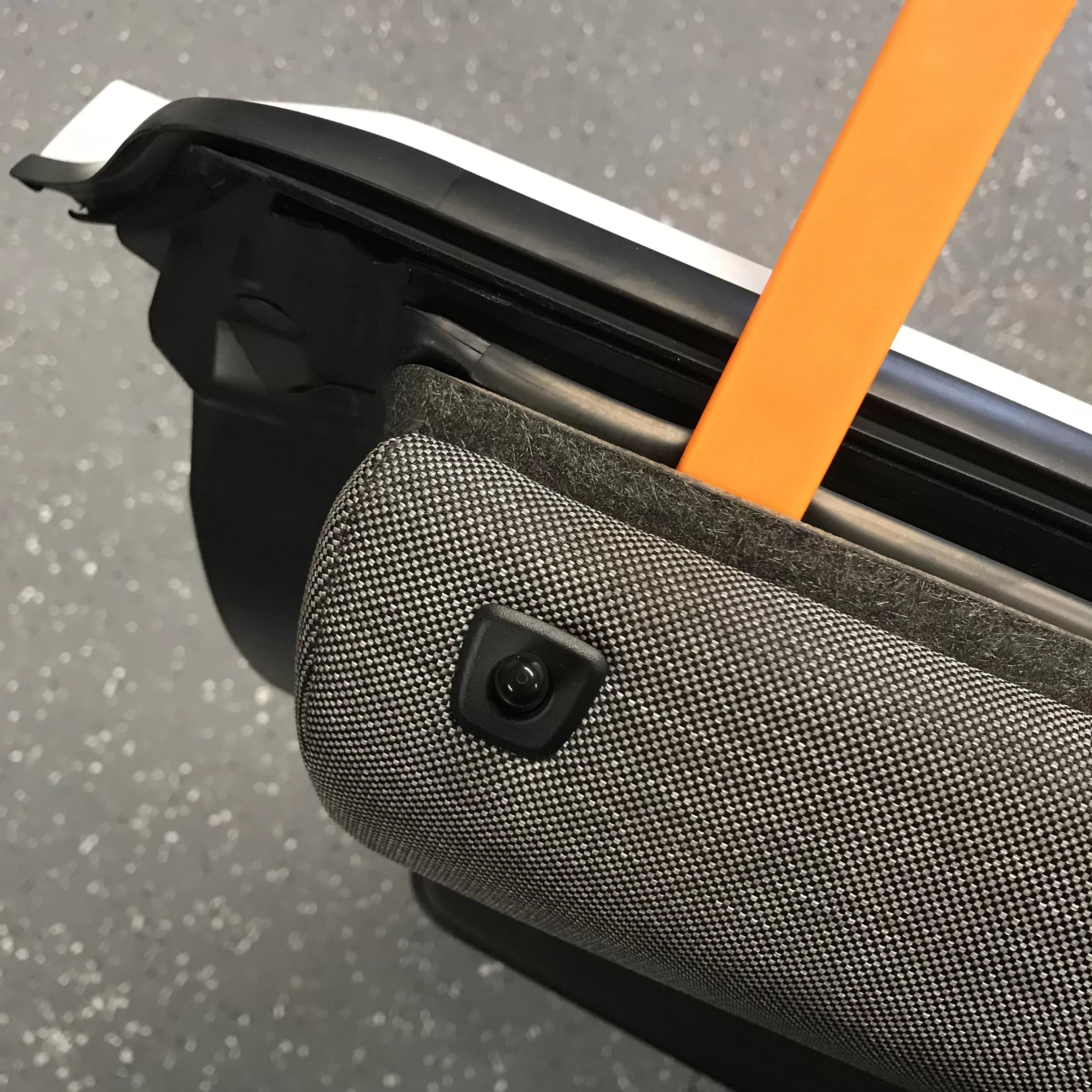

There are two pry points that took some trial and error. This wasn't really shown in Bavsound's video, so pay attention here:
Second pry point here:
Don't get scared, the door cracks open and it's really not a big deal. Take plenty of pics in case you get worried you can't put it back together. You'll have that for record, me and Bavsound to help you out. You'll be fine. Remember, I'm not really used to doing this either. I did it once before but I'm really not a sound guy. Wires scare me too.

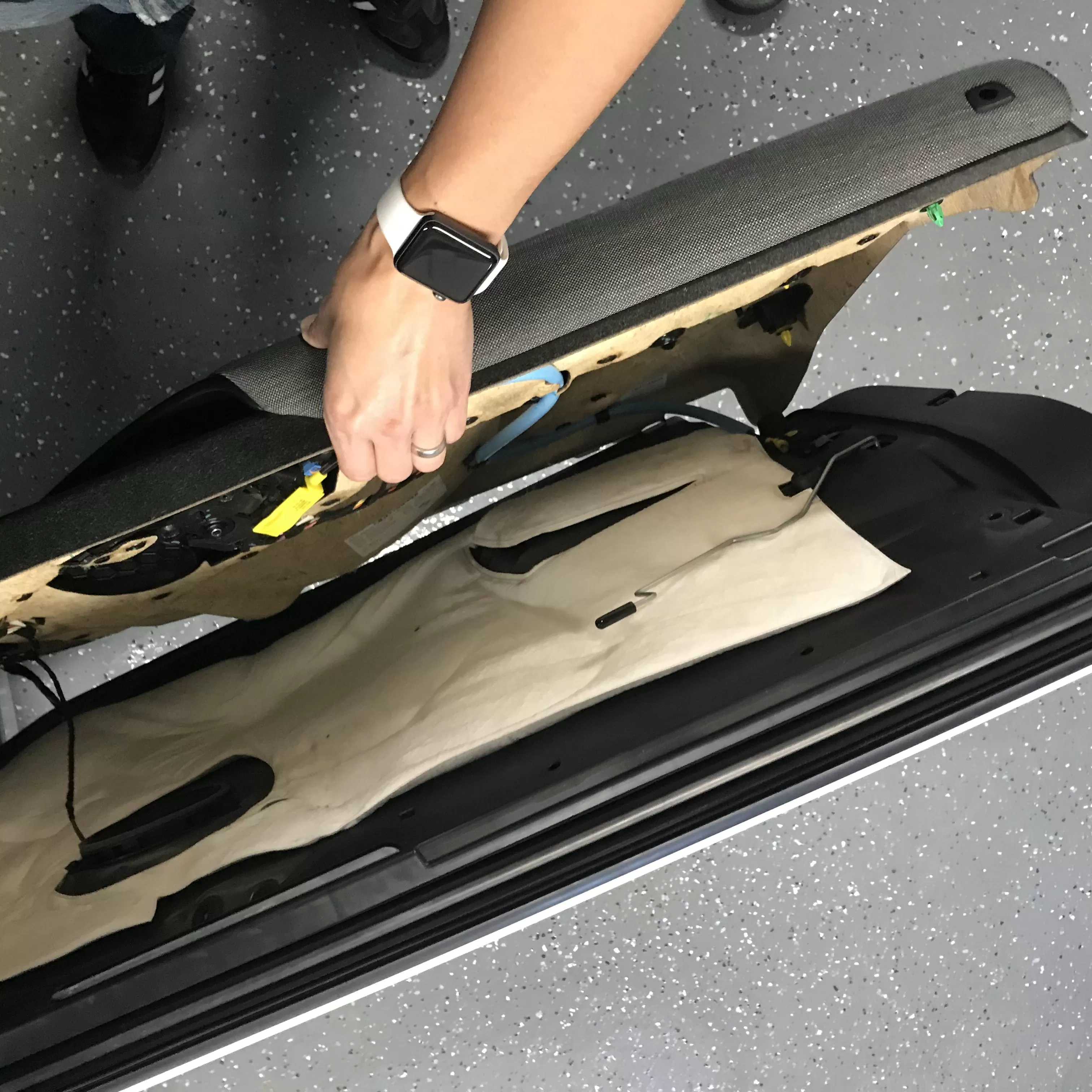

Next, you'll pull the door panel off. Before you do that, just make sure you're aware of it as you take the door off:
Lift the interior door up and then out. It's basically resting on the bottom of rail:
Bavsounds says to remove the door completely, but I that's more for access. You can reach stuff just fine if you have space to open the door wide enough to just lay the door panel flat like this. You can just rest it on the inside footwell. Put something else like a paint can underneath too if you want. I didn't.

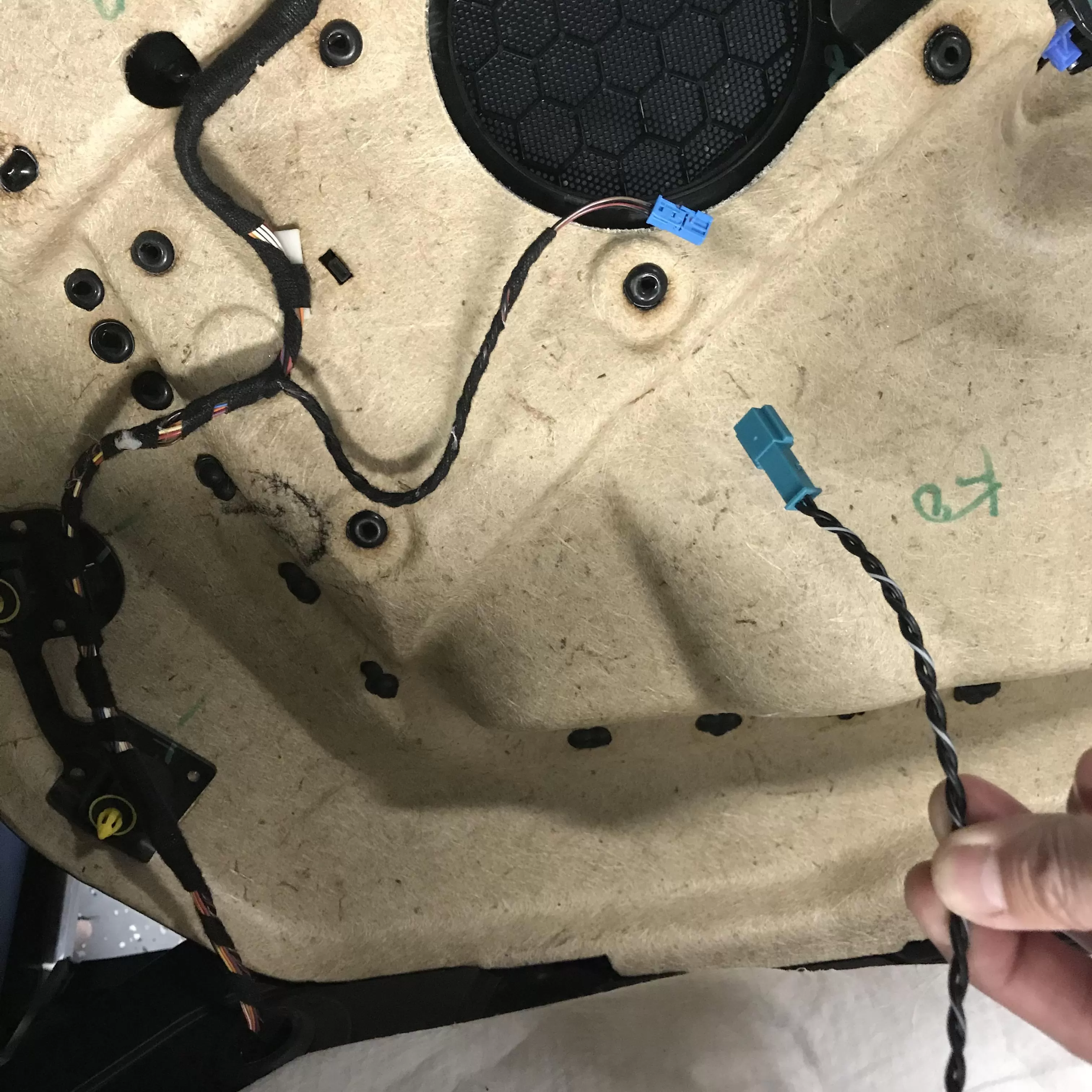

Let's take a look at everything. Make note of the blue plug. That's the only thing you need to remove. Bavsound asks you to remove a bunch of stuff on the door but that's only to remove the entire door panel. Like I suggested, if you lay the door down on the footwell, you won't have to remove the panel entirely and therefore you can avoid unplugging stuff and having to remember where to plug them back in. We're going to work with only the speaker wire. This allows you to do just that. Minimizing the amount of stuff you unplug I feel is safer. Fewer things to remember and document for putting it back together.
Make note of what needs to be unplugged. You're removing the stock speaker to replace it with the new one.

Once you pull the speaker out, you'll see how it's wired. Yes, you'll have to cut a small slit in your plastic to feed the car's speaker cable to the speaker. It doesn't quite go back in the way the new one came out. The wires feed in differently. Tough to explain, but Bavsound does a good job of it in their video. You'll need to cut a slit in your black plastic to feed wires through. Smaller than this.
Before you put the Bavsound speaker in place, be sure to use the foam rings they include in the kit. It adheres with self adhesive:

The only thing you'll really need to worry about is the lock pin on the door. Make sure that's aligned with the hole in the door panel before you settle it in place and secure the allen screws back in. Remember that I forgot to do this the first time around and wasn't able to lock my door until I came back home after a joy ride and spent a full 5 minutes doing it. Save yourself 5 minutes and just get it right but aligning the door lock pin.
