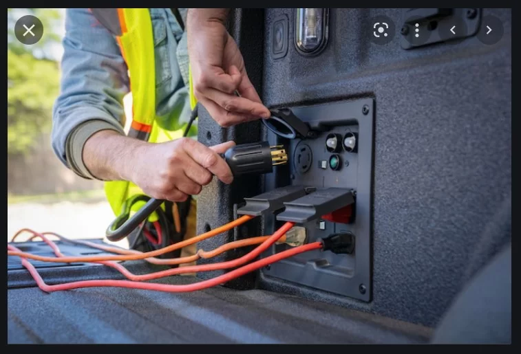

@Fastnf Thank you for your fast and detailed reply. What is I wanted to power would bit more than a cell phone charger and one small light. Maybe power a TV, few LED lights and a small refrigerator? What would be reasonable? I see the new F150 Lightning advertisements with all kinds if stuff "plugged in". Can this be replicated on my Mach-E or will Ford add such a feature down the road? Thanks again!
@Fastnf Thank you for your fast and detailed reply. What is I wanted to power would bit more than a cell phone charger and one small light. Maybe power a TV, few LED lights and a small refrigerator? What would be reasonable? I see the new F150 Lightning advertisements with all kinds if stuff "plugged in". Can this be replicated on my Mach-E or will Ford add such a feature down the road? Thanks again! View attachment 13584
The F150 shown has 9.6kw (9600 watts) and is pure sine wave inverter (not cheap). It 65 time larger than the Dewalt. For what you want you probably need at least 800 watts and it would need to be connected directly to the positive post of the battery and the ground on the car. Your not going to get 800 watts out of a dash socket. 800 watts from 12 volts is 68 amps. Your going to need 4 gauge wire to connect everything. It can be done but I would recommend you know what your doing before trying it. There are a number of threads on the form that cover the details
