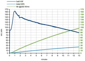

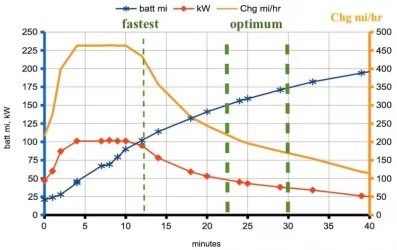

We don't need to kludge an aging technology that is rapidly going away. For example, charging my 2019 Std Rng Plus Model 3.
April 2019:
This graph generated from transcription of a cabin dashcam. Notice the car starts with 25 miles already in the battery. If you scale the charge, in 13 minutes it adds 75 miles versus 100 miles a year later.
April 2020:
This graph was generated from OBD data collected by "Scan My Tesla." Notice the car starts with 0 miles in the battery. If you add the 25 miles start from a year earlier, it becomes 125 miles in 13 minutes, much faster, 125%.
