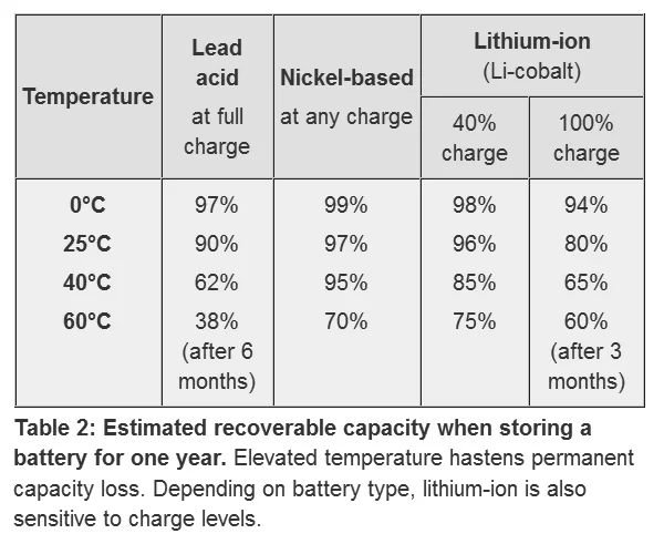

Battery University says: "Li-ion has higher losses if stored fully charged rather than at a SoC of 40 percent."
And also:
Full article here: http://batteryuniversity.com/learn/article/how_to_store_batteries
Battery University seems to be suggesting long-term storage should be at 40% or 40-50%; other sources recommend storing at 50% state of charge.

May I suggest, Domenick, that you look more carefully at what it actually says:
Table 2: Estimated recoverable capacity when storing a battery for one year... Depending on battery type, lithium-ion is also sensitive to charge levels.
It's not saying that the batteries lose charge when stored on a shelf. It's saying that they lose capacity when stored on a shelf. It also says "depending on battery type", so perhaps not all li-ion chemistries are sensitive to SoC level in long-term storage.
