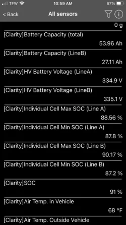

I'm row 217 in the battery capacity data table. You can see I reported 45.5Ah when the problems were occuring. At other times, like right now (below), it reports in the ~53 range.
I hadn't seen the report generator tool. I'll see if I can get it working and upload a full report. That's really cool.
