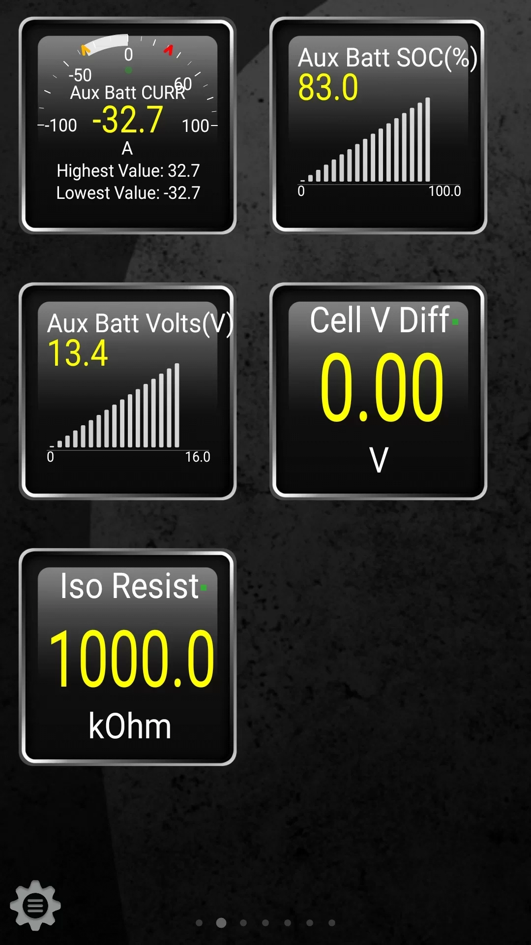

If you are a bit technically proficient, you can use SoulEVSpy with your phone (or Torque Pro) to see what the voltages are on the 90-some-odd cell groups, and see if any of them are significantly (0.1V) different from any of the others.
Yes, From Torque Pro:-
