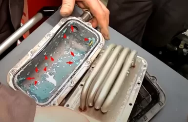

It’s way more primitive than I expected. The fault caused an insulation error in the HV wiring.
It does not surprise me the fuse was not properly thermally rated or HRC protected, such a trivial part could have caused major implications. Not a really inspiring way to cut costs.
Я звернув увагу на ці відкладення, можливо це проблема засмічення системи охолодження АКБ. Кристалізація теплоносія
This is ludicrous, jelled LC coolant at its worst... get this stuff out of my car. Not sure a high powered flush will dispose all of this junk from the system, no wonder those Ionics are having such issues.:mad::eek:
