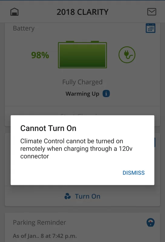

So a few days ago I was getting ready to head out for work and tried to start the remote climate.
What I noticed was that on an L1 charger if the battery warmer is running, then remote climate will not start. (Note that in the screenshot it's not charging)
Looks like the L1 charger just doesn't have a lot of juice, we already knew that it can't both charge and start heating the cabin but this was a new one for me!
tl;dr when on L1 charger, can only do one of:
- charge battery
- remote climate
- battery heater (Canadian model)

I get that message sometimes in CA with temps in the 50s... I'm not sure if its the App or what but yeah its dumb sometimes... I had it spam the crap out of me the other day when trying to start heating
It was supposed to have started @ 7:40 automatically but failed, so I tried starting it a few times manually and it failed with that same message, then finally got super mad at me and started spamming me lol
