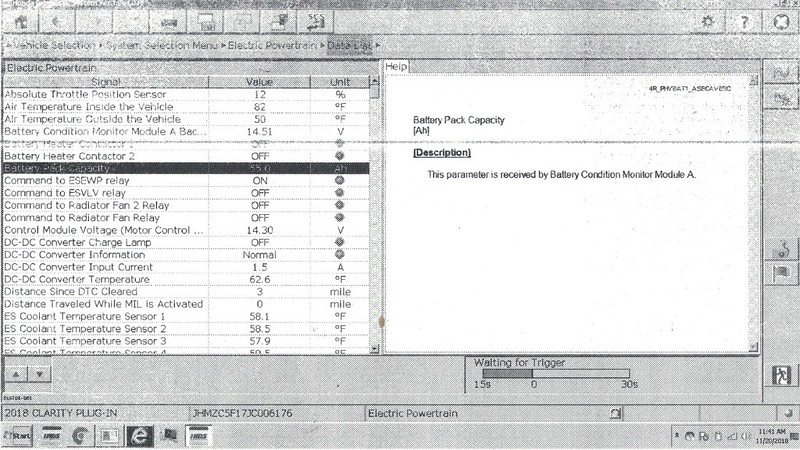

I had to ask repeatedly, but finally got my dealer in Chattanooga to do the test for free and provide me with a screenshot before delivery. Thanks to this forum I knew to ask.

My printout on delivery, by the way:
I see the values are not exactly the same for all parameters of the example given in the PDI
So I salute your dealer for actually running the Battery Capacity Test for you and not just giving you the page from the PDI.
