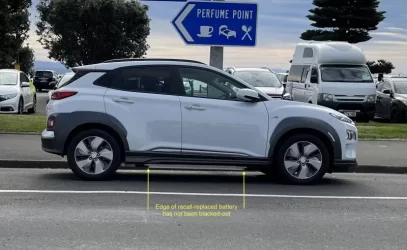

... I'm looking to buy a 2019-2021 ...
Keep in mind that most 2019 examples will have a new battery fitted due to a major recall, easily identified, see image below. According to recent prospective-owner inquiries on reddit.com/r/KonaEV/, some that were "repurchased" by Hyundai are now being resold at bargain prices but with a salvage title or whatever the equivalent is in your region.
Also there is a current TSB/recall regarding all examples with blue coolant. The change was made mid-2019 from green (or pink). This is not a great concern in the big picture but the work will need to be done if it hasn't already.
