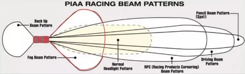

Those of you with the iconic Mini fog lights: Are those not traditional fog lights which shine light lower and forward down the road, overlapping slightly with the beams from your headlights? I've been doing a little research on the 2022 integrated headlight situation, and, from what I can tell, the 'bad weather lights' and the cornering lights are the same thing.
Hitting the bad weather light button simply turns on both cornering lights, illuminating the ground to the left and right of the Mini. I have not driven in dark, bad weather yet, but I'm not sure how useful these will be in that situation. I'll have to take a night drive on a deserted road and see if they provide any additional forward illumination. To be fair, the regular headlights are so good I'm not sure supplemental lighting is needed, anyway. But the 'bad weather light' almost seems like a marketing ploy.

I don't believe fog lights were ever meant to illuminate forward down the road. Their intended purpose is to illuminate close to the front of the car in a wide pattern to help with visibility of the road lines in heavy fog and bad weather. That wide beam pattern is functionally equivalent to "cornering" lights so it makes sense to me to have them be the same thing (and I came to the same conclusion that the cornering/bad weather lights are the same light source)
For what it's worth, when I tested them the bad weather/cornering lights did exactly what I expected and did illuminate a noticably wider area.

I can attest from personal experience the 2021 fog lights make a huge difference, and they're not the same as the cornering lights. I live in an area where I regularly get dense fog with visibility measured in tens of feet, depending on the season and drought conditions. Which is why I so badly want working rear fog lights. My first MINI had a single rear fog light. I guess I never considered until now I could try modifying my SE to disable one of the existing (unused) rear fog lights and install the necessary switch to activate them.
I'm skeptical the "bad weather lights" would work as well, because I don't know if they'd point down enough to avoid reflecting too much off the fog. That's something that would have to be tested. Not sure how much foggy weather Germany gets, but the UK is notorious for it.
I don't think the roughly 1ft difference in height between the bad weather lights (at the bottom of the headlight assembly) and the 2021 fog light location would make too much difference in performance. The beam pattern and downward angle should matter much more than the height.
