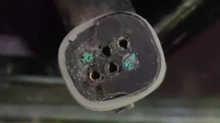

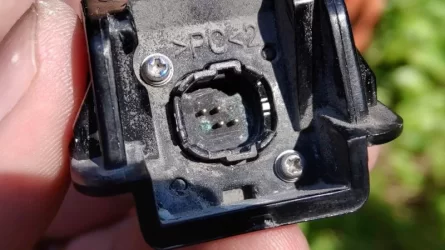

I'm in the same boat, and am looking at the connector pins. It looks like there might have been a fifth pin that broke off inside the connector, but it's hard to tell. I've attached photos of the back of the camera and the connector. Is there anyone who's pulled their camera and can confirm that it only uses 4 pins? Thanks.
Edit: I've also used the diagnostic screen to confirm that my camera reports ok, so it's not likely there's a missing pin, but just want to confirm. I'm thinking camera failure as well.

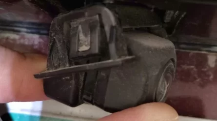

First time I took all the trunk liner off and went at it from the inside. I learned that the camera is just held in place by two flaps that snap outwards from the camera. If you look at it with a flashlight, you can see them on either side. I used a knife and a small screwdriver to slowly move one of them inwards until I could get that side loose, then I did the other. If it's just the camera, that's a much faster method. However, I see replacement cameras come with the connector wire, so I need to determine what connector (they're all white, but 6-pin? flat? square?) is at the other end before I order a new camera.
Edit: added a photo of the flap that holds the camera in place. You can see it above the horizontal plastic, it's leading edge looks like a large 'U'.
